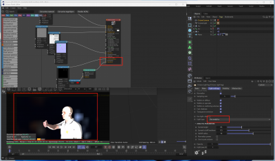

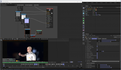

When I use analytics light and sss material together, strange things happen to the characters
But when I use primitive lights, or close the transmission channels, it goes back to normal
Why does this happen? The file is attached.

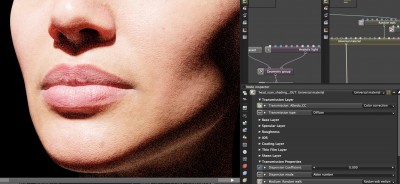

1. When using Universal Material, transmission, when "enabled", is defaulted to a Specular mode
2. The asset seems to be a simplified character where maps separate shading parts, this is not ideal and may require the use of a composite / mix node setup or splitting geometry
3. Is the scene scale plausible?

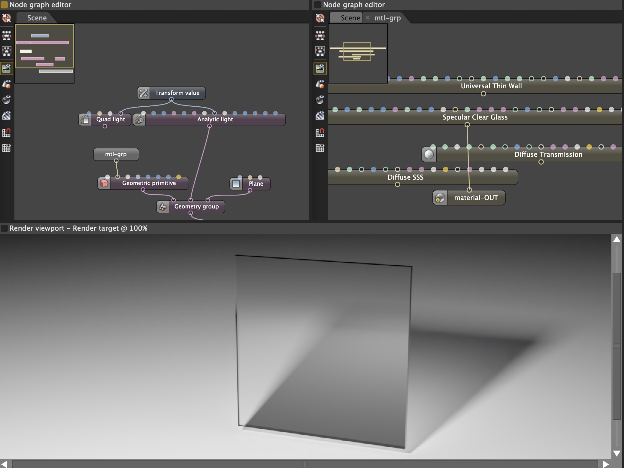

No issue on Octane 2024 (Stable Release),
- the analytic light is the only light source,
- material is universal with transmission and SSS medium:
- PT kernel

Analytic lights are not compatible with transparent materials, sadly.
Puget Systems / Intel Core Z790 ATX / RTX 4090 / Cinema 4D
skientia
Posts: 239
Joined: Tue Mar 12, 2024 1:50 am
jayroth2020 wrote:Analytic lights are not compatible with transparent materials, sadly.
Could you elaborate? So far, Analytic light worked on all tested transparent materials, meaning any material that let rays transmit through (clear glass, paper sheet like, SSS), with the PT kernel. Is there an instance not tested / shown, where it does not?
v2024 stable
Octane resources
OCTANE POSTS (URLs have changed, which will break some links but all content remains available).
jayroth2020
Posts: 486
Joined: Mon May 04, 2020 7:30 pm
Yes, sorry, I was referring to analytic spot lights and fog. These elements are clipped by transparent surfaces.
