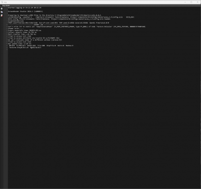

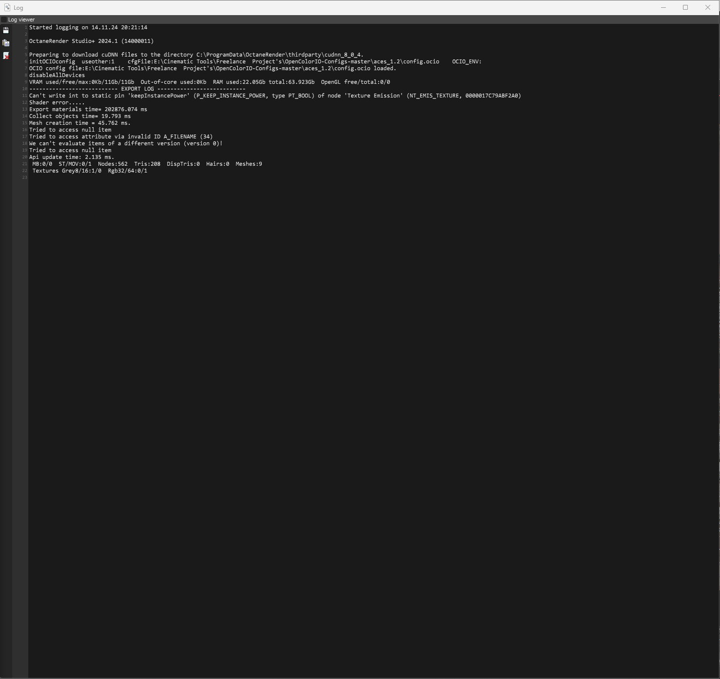

Im getting this error im a little confused about i thought i could fix it by turn all the compatability modes on my textures and other octane objects to 2024 but the screenshot is the latest error after trying that so any help would be greatly appreciated.

It is probably a minor bug which caused by unavailable parameter access. Not a thing to cause any critical error.
Posts: 10612
as Ahmet said , Keep-instance-power is not a critical issue, for example, the Haze object has the option enabled in the emissive node, but it is a single object.

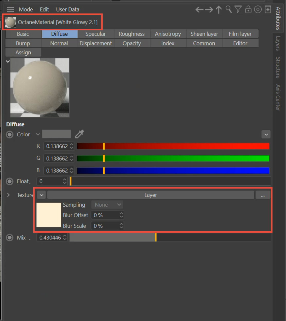

The big issue in your scene is that it is full of unsupported C4D Layer shaders:

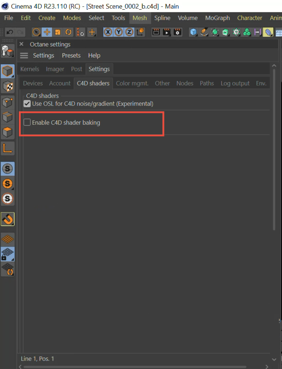

If you go to c4doctane settings/C4D Shaders, and uncheck the "Enable C4D shader baking", the scene should work, but the materials will not be correct:
You need to revisit your materials, and replace all the C4D Layer shaders with Composite Texture node connected to Octane shaders only:
https://docs.otoy.com/cinema4d/CompositeTexture.html
