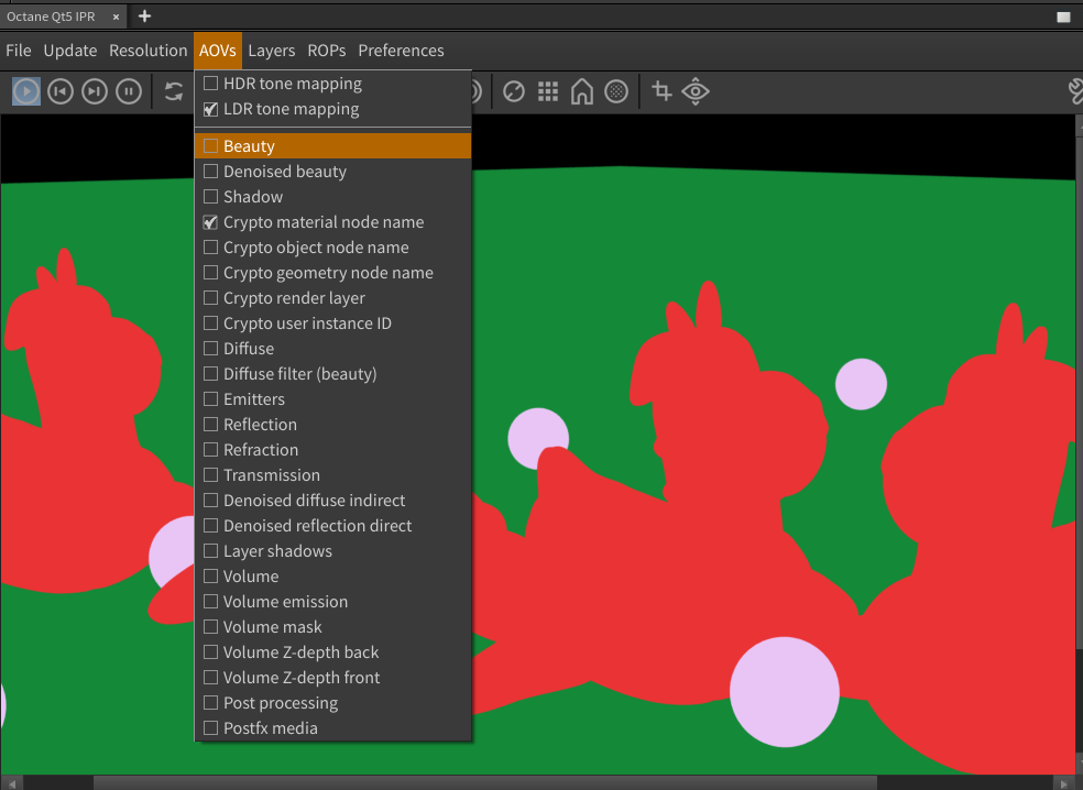

First and most important : when I switch to see some render pass there is no option to return beauty pass, we have HDR and LDR tone mapping which randomly doesn't work and in big scenes makes houdini crash and when it works resets the ipr ... I need to close ipr and open it again to see beauty
Render passes dont work on ipr some times. ie I added zdepth in this scene and it does not show up

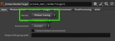

this one is old but in main houdini ui in shopnet render target we dont have the Photon Mapping kernel, I unlock the asset and plug it manually to work where I need caustics.

The HDR and LDR options were intended for the cryptomatte AOVs, so that you can see what is being affected correctly. There is definitely a beauty pass AOV you can select again please see attached.First and most important : when I switch to see some render pass there is no option to return beauty pass, we have HDR and LDR tone mapping which randomly doesn't work
See the attached, Photon mapping is available and working. Please confirm which version you are running - are you using a custom HDA perhaps? Try deleting the plugin folder and copying a fresh one unzipped from our releases. Let me know if the updated 'install' works.this one is old but in main houdini ui in shopnet render target we dont have the Photon Mapping kernel, I unlock the asset and plug it manually to work where I need caustics.
