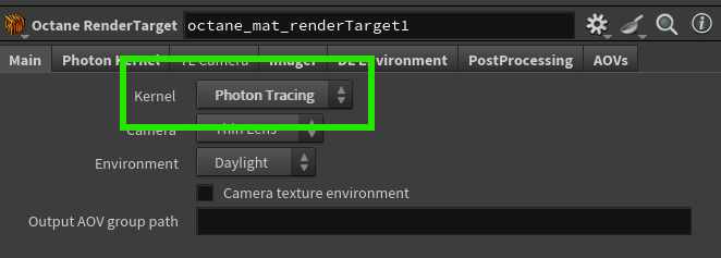

this one is old but in main houdini ui in shopnet render target we dont have the Photon Mapping kernel, I unlock the asset and plug it manually to work where I need caustics.
See the attached, Photon mapping is available and working. Please confirm which version you are running - are you using a custom HDA perhaps? Try deleting the plugin folder and copying a fresh one unzipped from our releases.

Ok I see you were talking about shopnet, SHOPS are depreciated as far as I know we only support the Material network for materials and RT etc.
