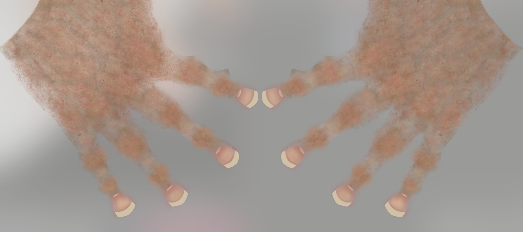

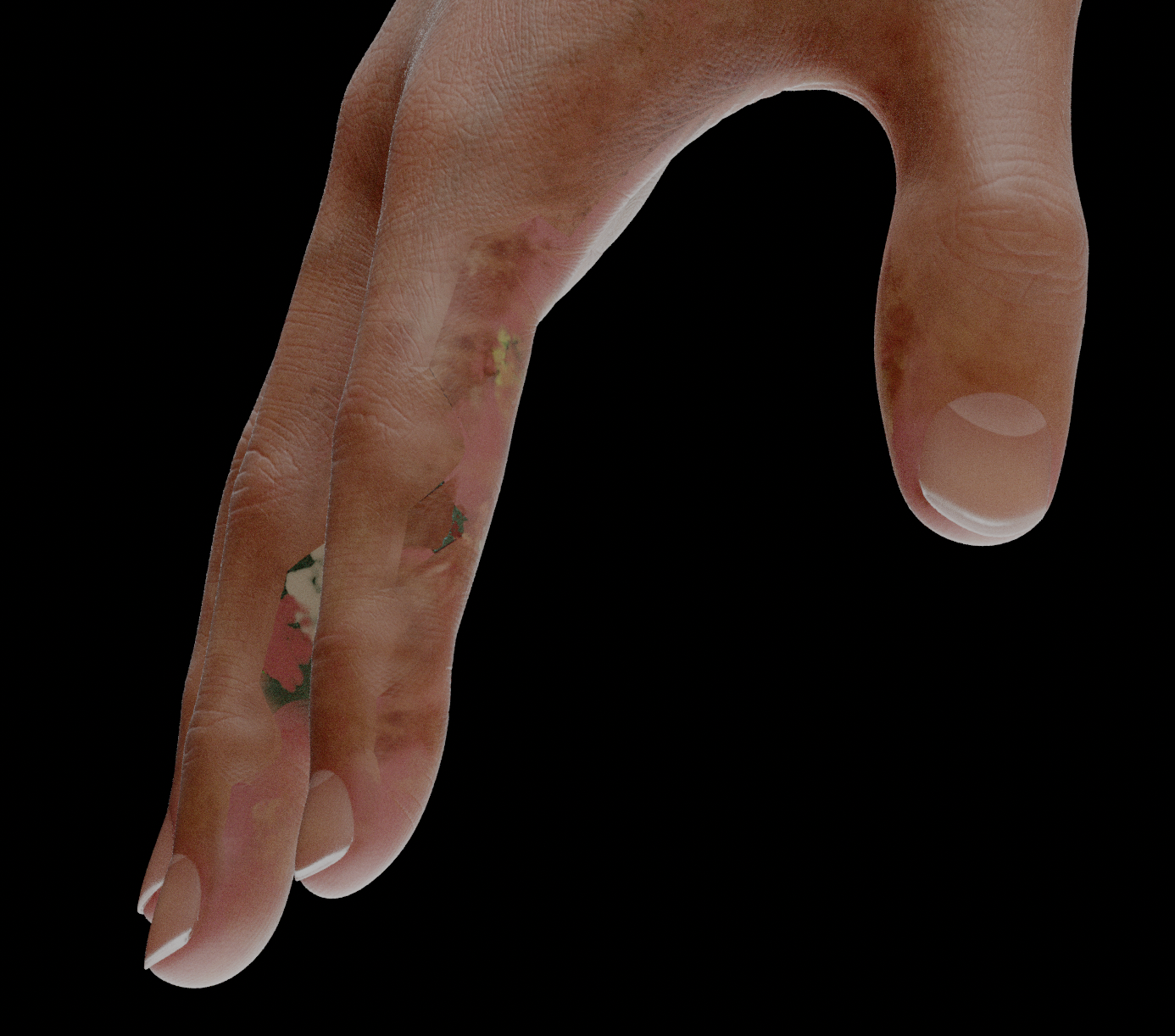

I am converting a cycles material to octane and run into a strange issue. The UDIMs look perfectly fine in Cycle but have a strange color "fringe" when using the same textures in Octane. Any idea would be greatly appreciated.
Cycles Preview Render without Fringe
UDIM Texture used in Cycles and Octane
Octane Preview Render with the fringe

Can we see the UDIM shading setup in Octane?

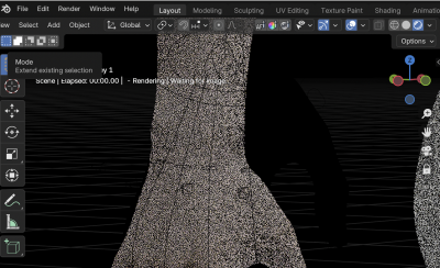

The color fringes are gone with 29.16 and using the node tree you supplied.
But panning/rotating/zooming or changing the material node tree crashes the Render Server.
This is the last message displayed.
When the message is displayed Triggering Shaded Mode and then engaging the rendered mode crashes the render server.
