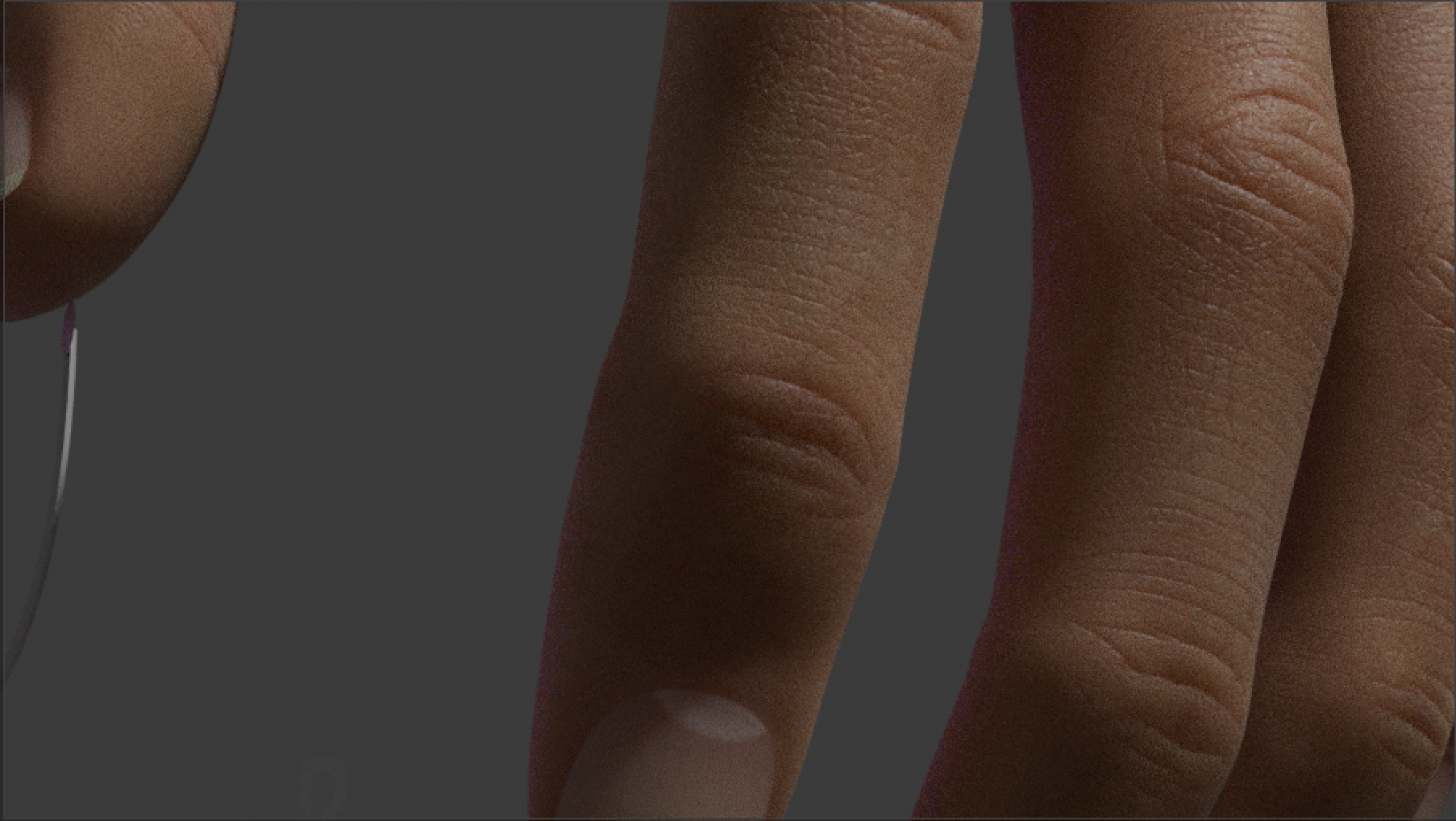

I am converting a cycles material to octane and run into a strange issue. The UDIMs look perfectly fine in Cycle but have a strange color "fringe" when using the same textures in Octane. Any idea would be greatly appreciated.

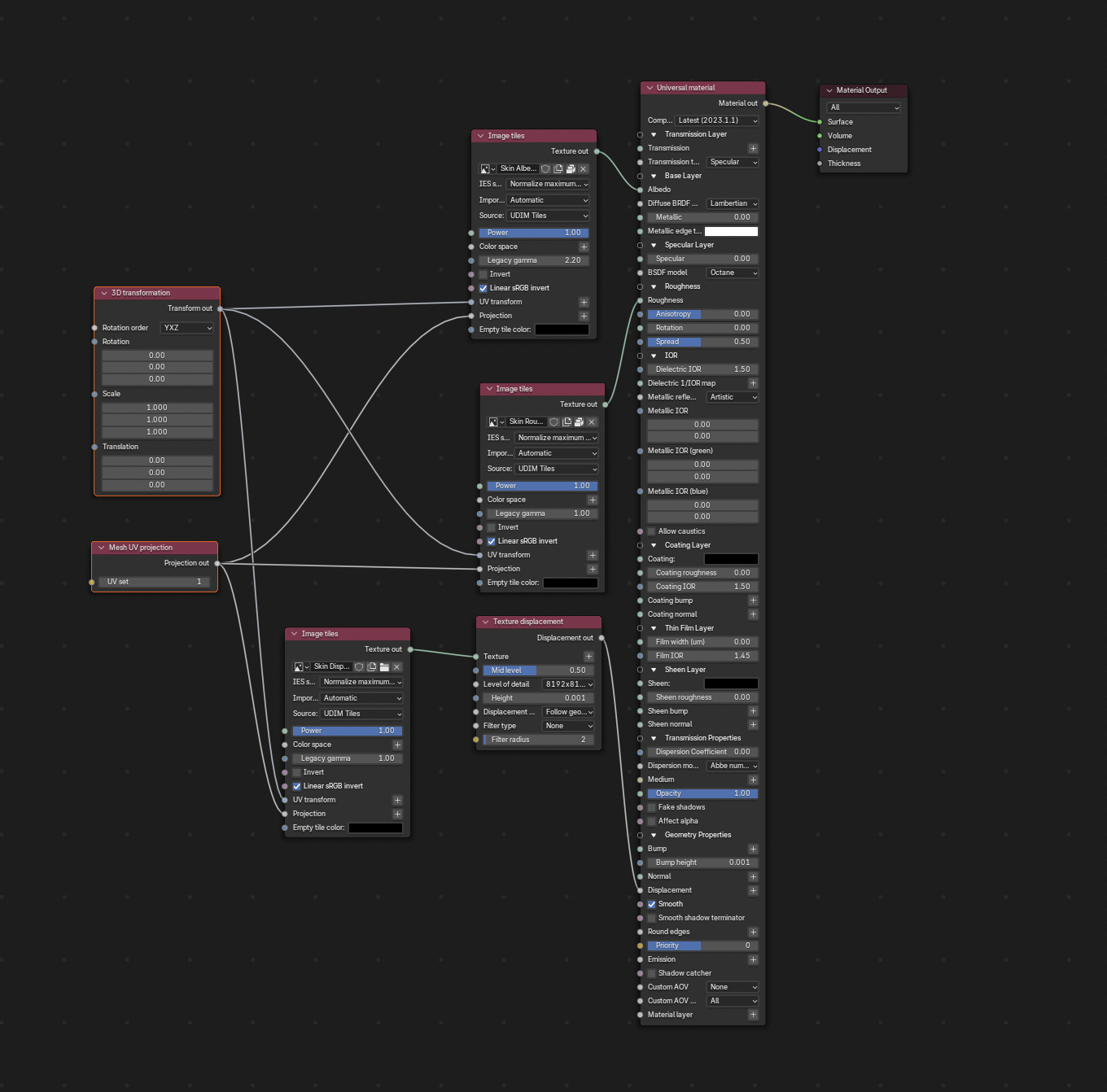

Can we see the UDIM shading setup in Octane?

Any chance you can share your project file with me?

The color fringes are gone with 29.16 and using the node tree you supplied.
