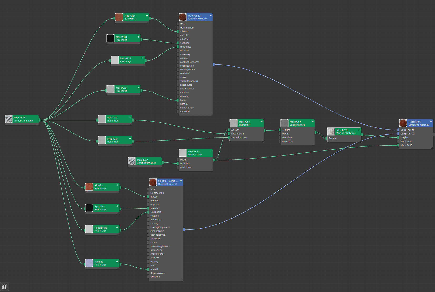

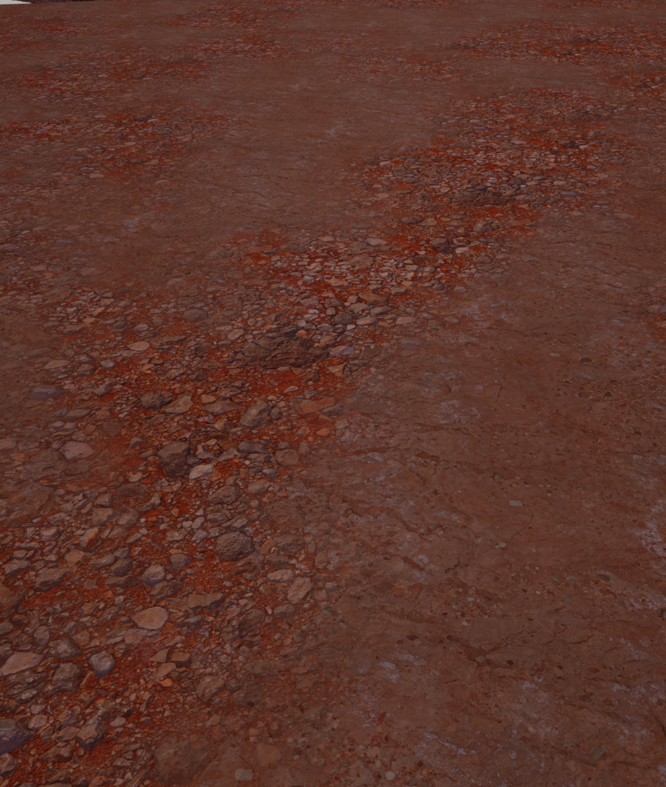

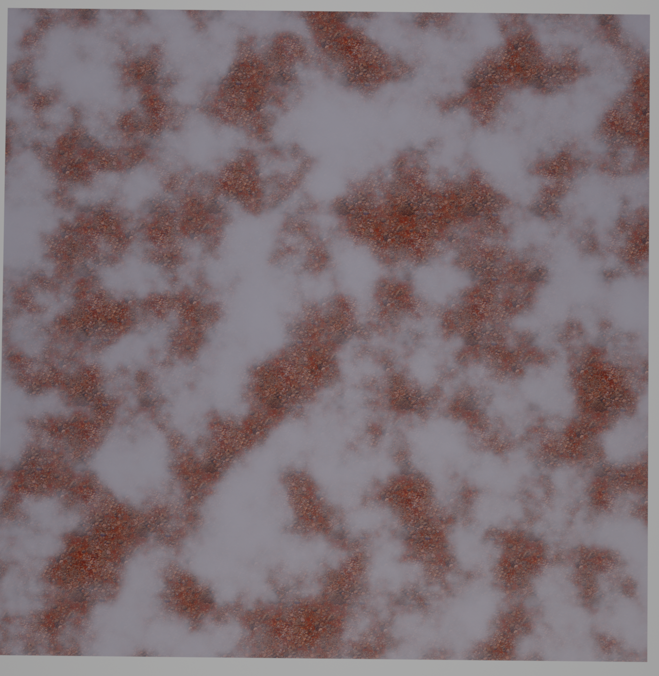

I need a composite texture for landscape, two materials, and then a simple noise map for the mask. See screenshot of mask applied.
Everything works up until displacement.

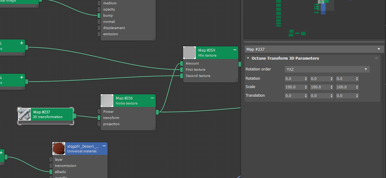

For displacement, I added a mix texture node, added both displacement texture maps and then in the amount I use the same mask as the composite node, I then baked it and add it to texture displacement> displacement channel in composite.

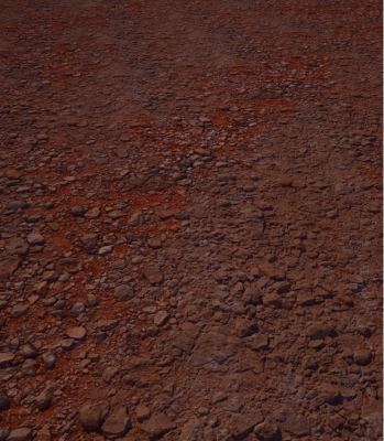

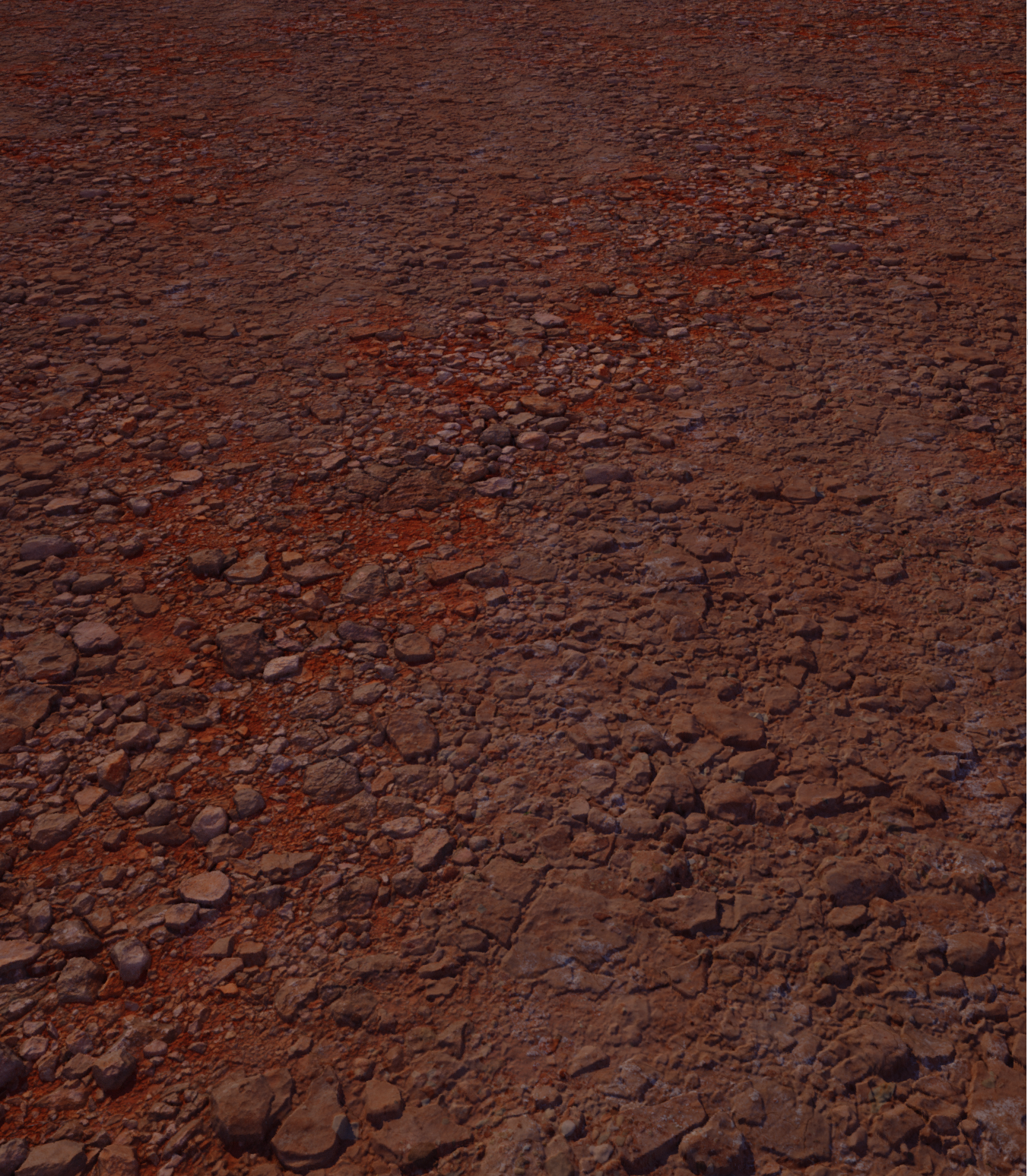

However, it is only picking up 1 of the displacement maps. See close-up screenshot it uses the same displacement for all.
I feel like the mix texture node is not picking up the 3d transform corretly that sits on the noise map?

SOLVED
I had to bake the noise texture without the transform applied...
