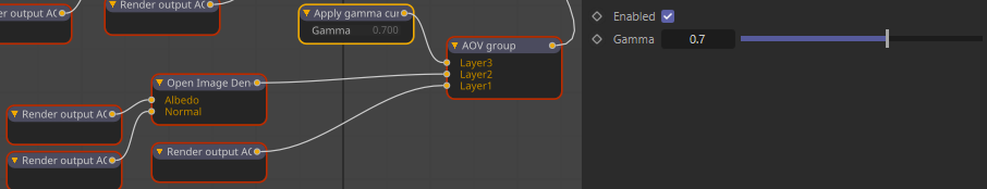

Since denoising render passes is always the same procedure are there any plans of implementing it as a tick box or something more simple than the current setup? Seems redundant to make the same set-up repeatedly for every scene that uses it.
Also, denoised lightpasses need a gamma correction of 0.7 to be identical to the normal light pass, is that avoidable? Am I missing something?

It was all within Cinema, attached screenshot shows what I did to the denoised light pass to have it match the look of the original light pass in the Live Viewer:
- I´m testing in another project now and this brightness/contrast difference doesnt seem to be the case there, not sure why it was the case in the original test project.

In case of a checkbox for each AOV to get denoised, I think this might happen in the core side so we could simply re-use it on our side but have to check.
About the Gamma issue, we'll investigate this, thanks!

Hi sivertbakkeng,
please check the Camera Imager.
Compositor works in RAW without tone-mapping, and it is expected to apply it on top of the Denoised AOVs.
If this is not your case, please share a link to the scene, even via Private Message, thanks.
