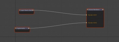

Hi, I read about the denoiser for AOV nodes. I have a scene where I render only Render Layer 2. The output is a "denoised beauty" and a "Black Layer Shadow" pass.
I want to denoise the Black Layer Shadow pass. How do I do that?
Denoise AOV Nodes HOW?
I have posted an example here, it is about denoising Light AOVs, but the process is the same for any type of AOV:
viewtopic.php?f=30&t=83664#p433908
