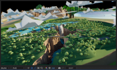

I've uploaded ORBX scene to the Network and got post processing pass rendered together with beauty pass (blended with it). I could live with that if that layer would have alpha channel. But it actually looks like a bug. Here is th output:
network output
network output

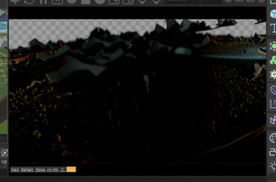

and here is the expected result:
expected result
expected result

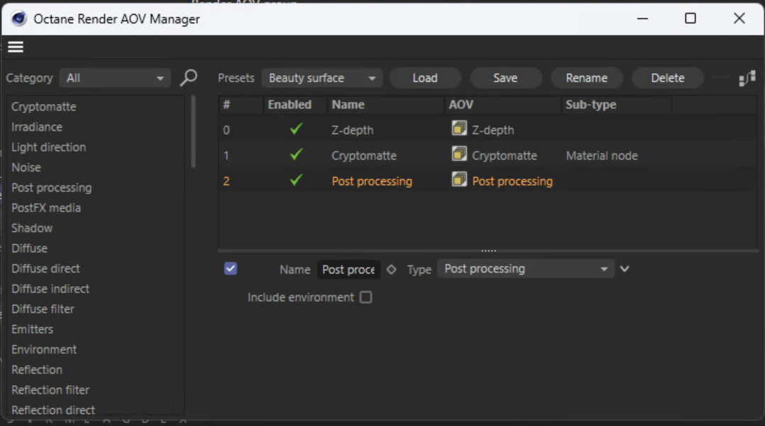

Maybe I'm doing something wrong? But I didn't notice this problem before. Below is my AOV Manager settings. Please, help to resolve the issue:
AOV
AOV

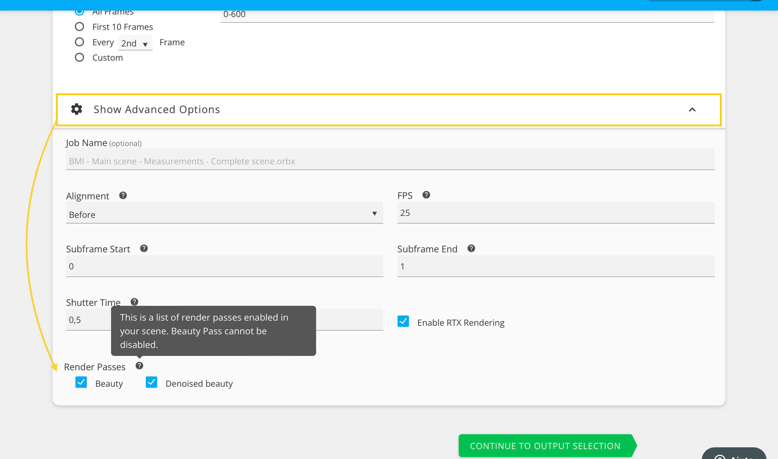

when you prepare a Job in RNDR, if you click on "Show Advanced Options", you can check which passes/AOVs are enabled in the .ORBX file:
Do you have the Post Processing AOV listed in there?

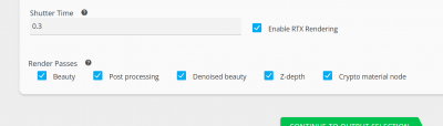

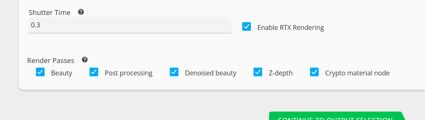

Hi, Beppe!
Yes, the pass is there.
