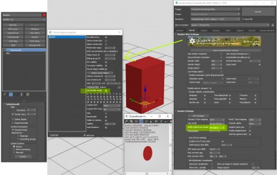

I want everything to be smoothed out in the render, but I don’t want it to be displayed in the scene and not load the location, but the function doesn’t work. Octane version 2024

Not even in v2023. Honestly, I'm not sure if it's possible, hoping that. Thanks, I'm going to report the issue to the developers.

Hi, this is how to :
If "Notify objects on render" is set to "all" it is for all objects...
