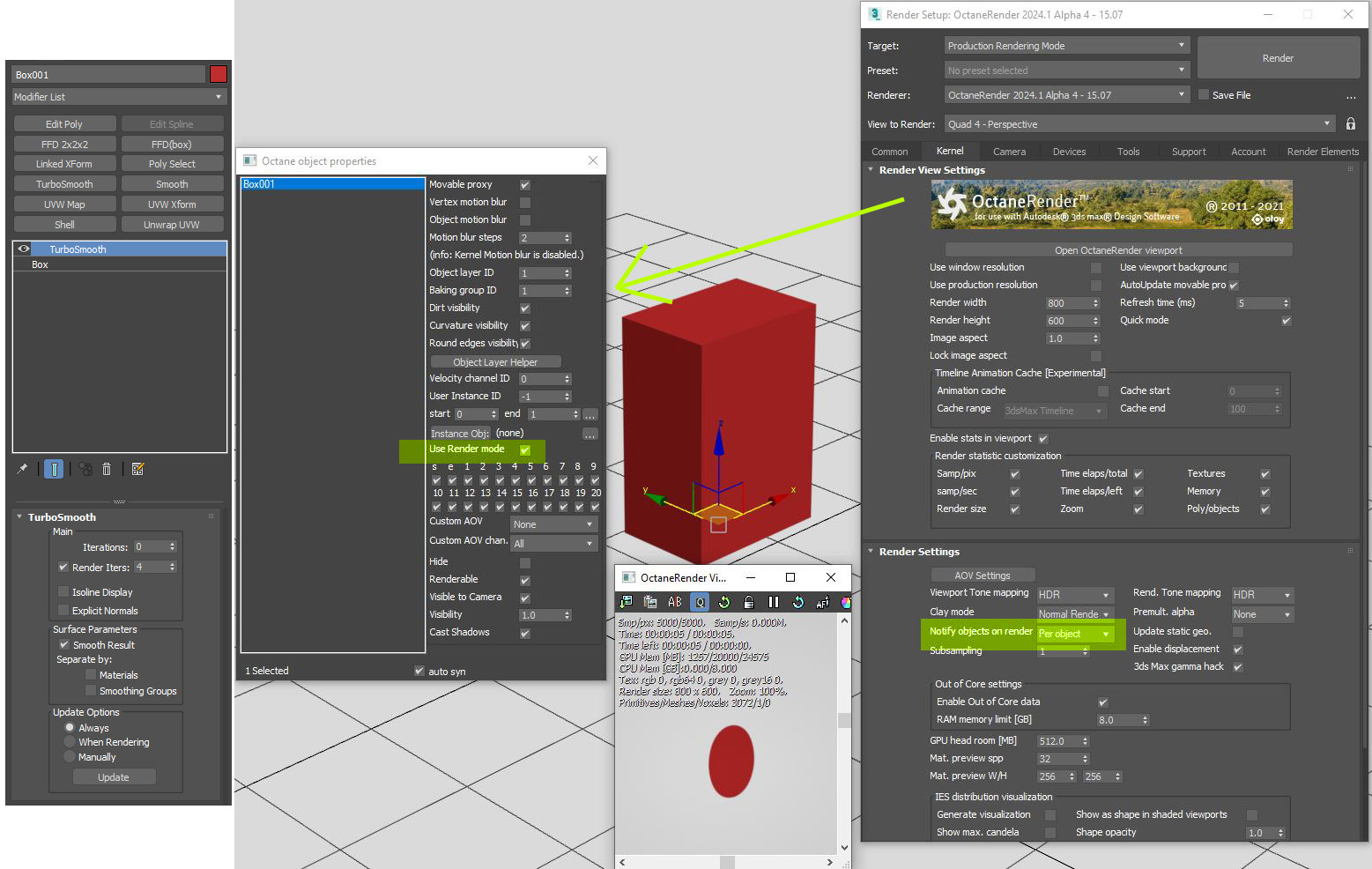

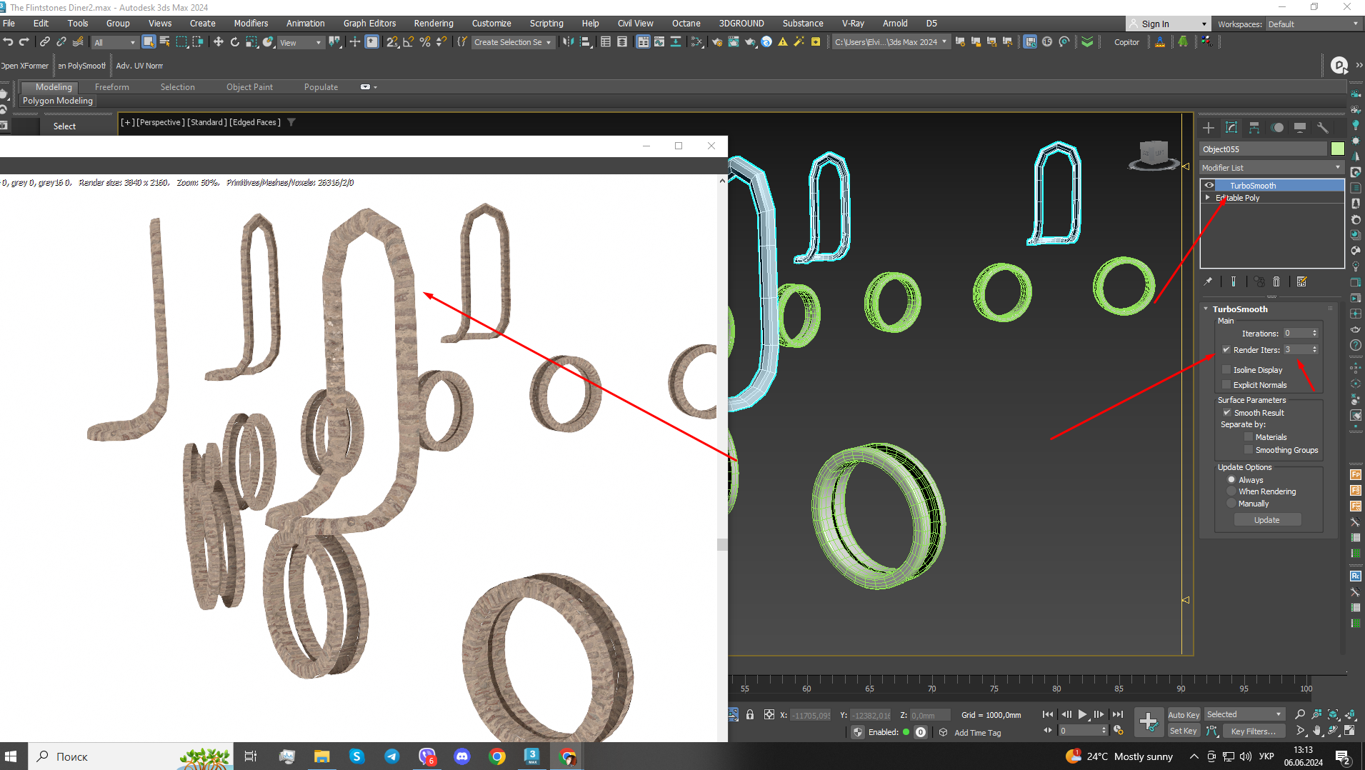

I want everything to be smoothed out in the render, but I don’t want it to be displayed in the scene and not load the location, but the function doesn’t work. Octane version 2024

Hi, this is how to : :-)
If "Notify objects on render" is set to "all" it is for all objects...
