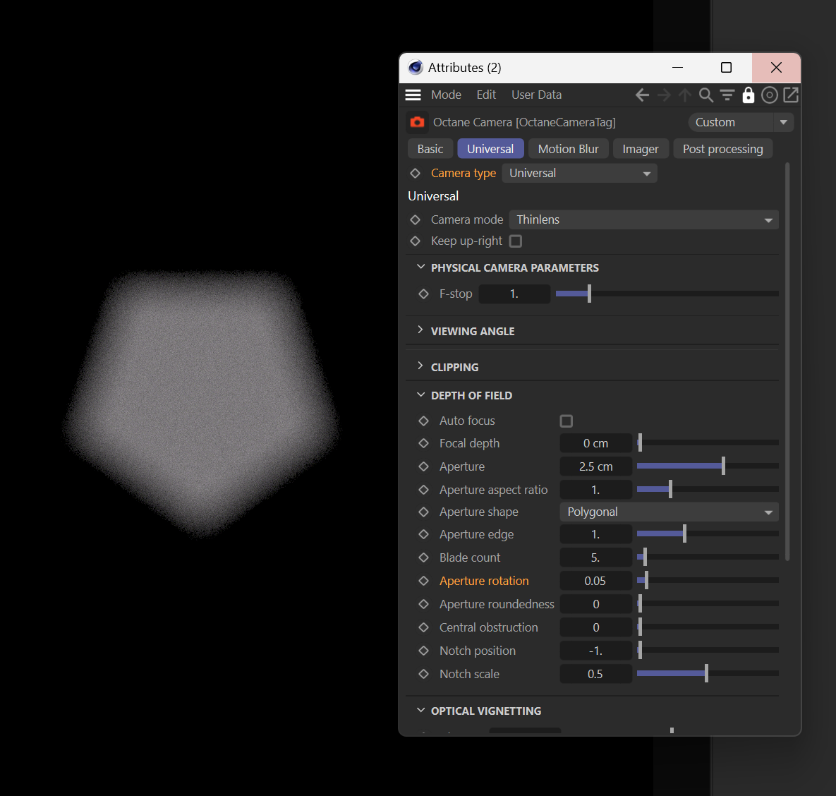

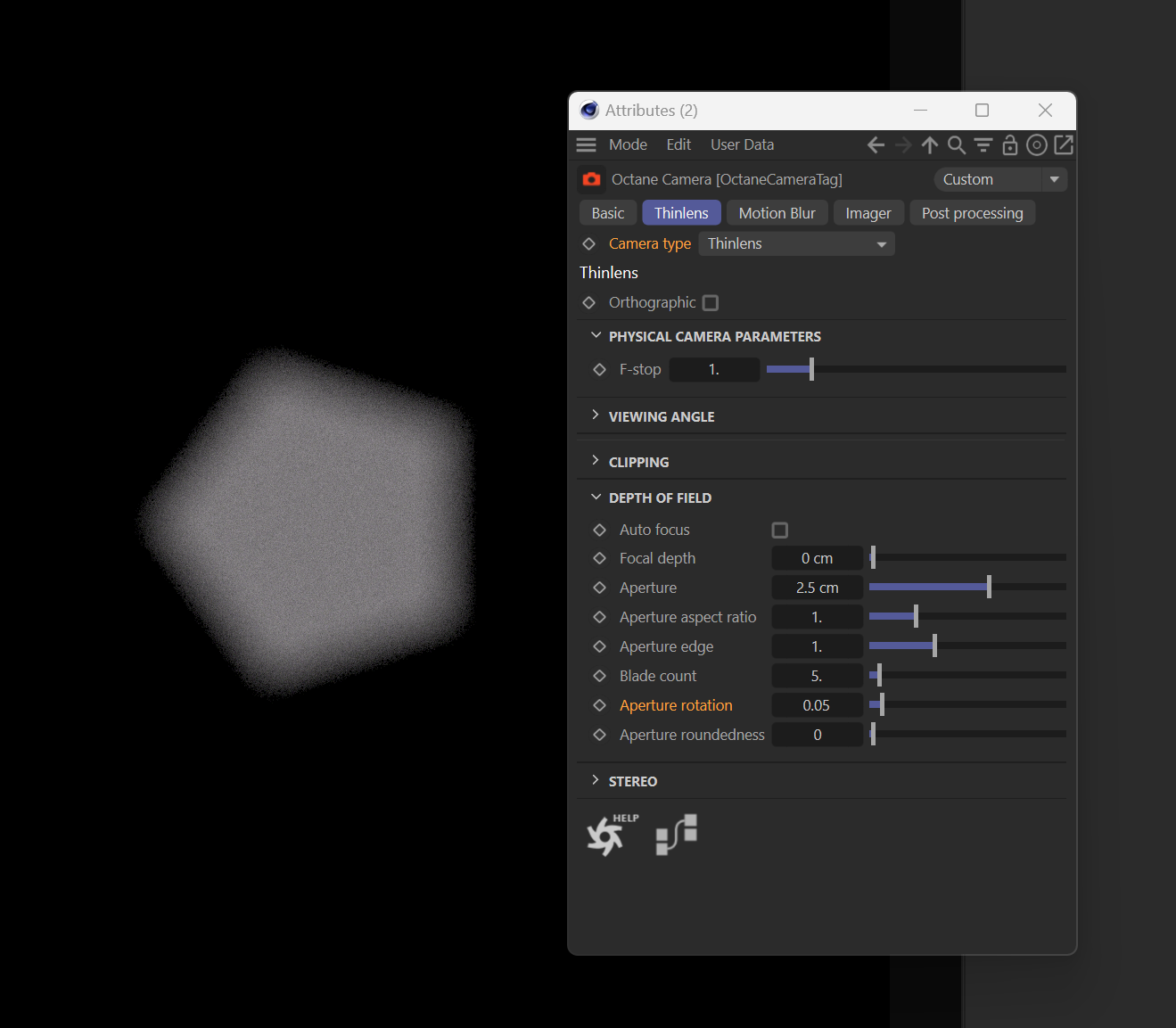

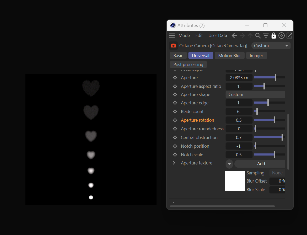

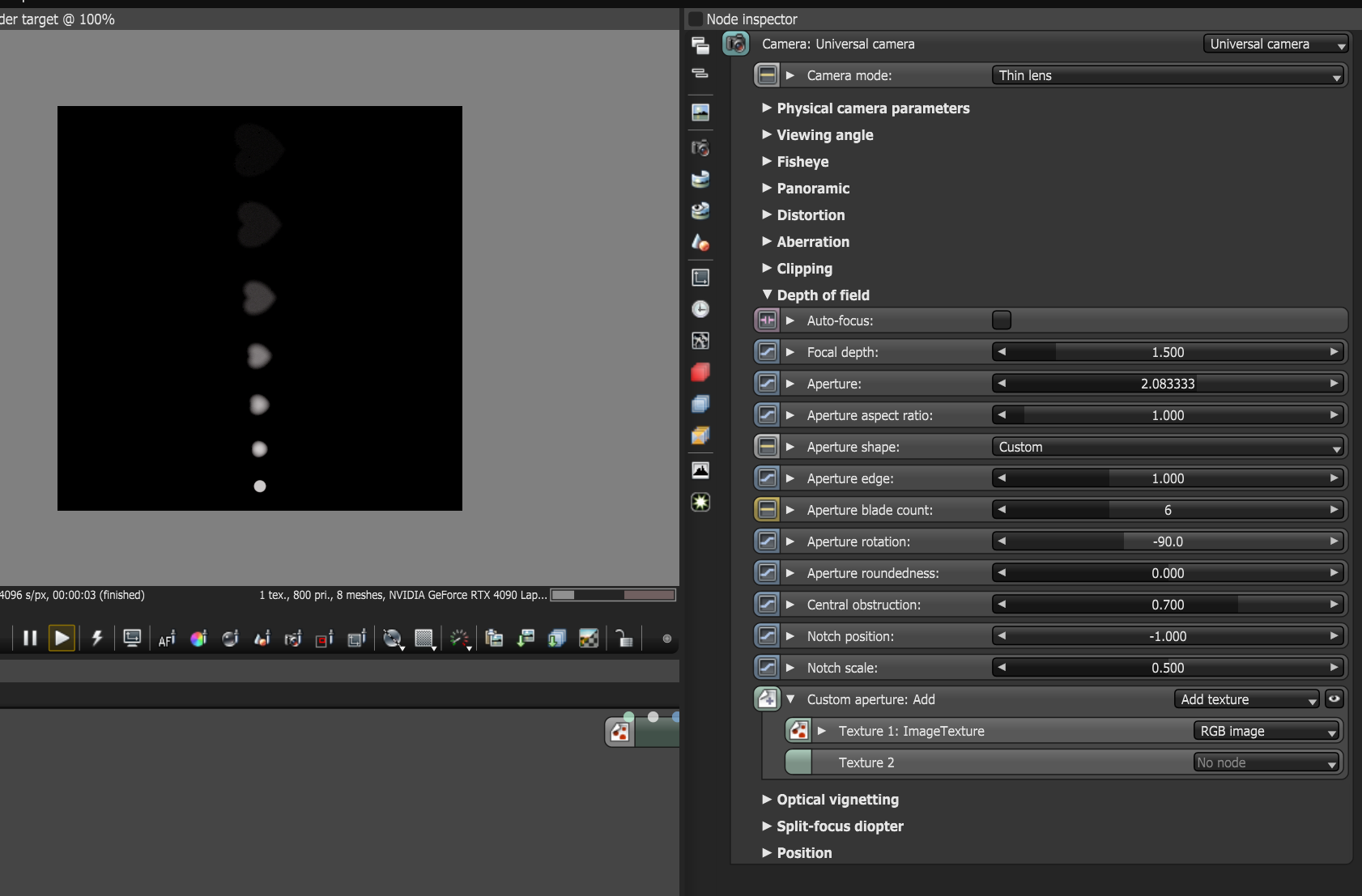

Universal Camera > Universal tab > Depth of Field section > Aperture Rotation does not work in the C4D plugin. It works in the corresponding Standalone app. Test files attached. Screenshots below:
Aperture Rotation slider does not work

It's working as expected! Please try to reinstall your plugin, it maybe related to some wrong resource files.

Still see the same behavior. Aperture rotation in the Thinlens camera type works ok. Aperture rotation in the Universal camera type does not. Simplified file here with just one sphere and two cameras. If you look through the ThinLens camera, it rotates as expected. If you look through the Universal camera it does not.

Thin lens camera aperture rotation working, but Universal camera aperture not rotating.
It's doing something else of what you think, but not noticable. But looks like parameter has different range and name in universal camera (like a rotation value -360 to 360). It's mistakely named on thinlens camera, should be "bokeh rotation".
