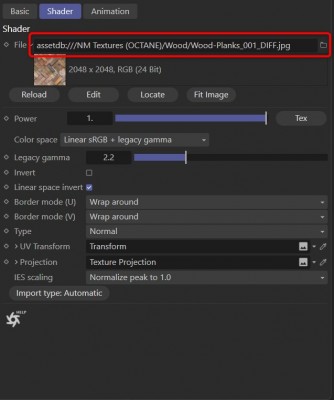

Always when I want to save my project with assets, the filename of my textures in the shader changes. This is really annoying.
In the attachment you will see the first picture before I save the project, the second picture after I saved it.
Maybe someone has a solution for this.

I'm not sure what you mean, Ahmet. When I do a Save Project with Assets in Octane C4D, all the collected texture files retain their original names; "tree_placement.png" etc.aoktar wrote:It does what you should expect from a collect operation, similar to other textures. Your request is like to want an option for your case.
I don't understand your answer. The correct file are saved in the tex folder, but the link in the shader is wrong so I always have to manually replace the pictures.aoktar wrote:It does what you should expect from a collect operation, similar to other textures. Your request is like to want an option for your case.
With the physical render all works perfect with "Save project with assets".
This is a really annoying problem. Not with small projects, but with bigger project it can take some time to exchange everything.
