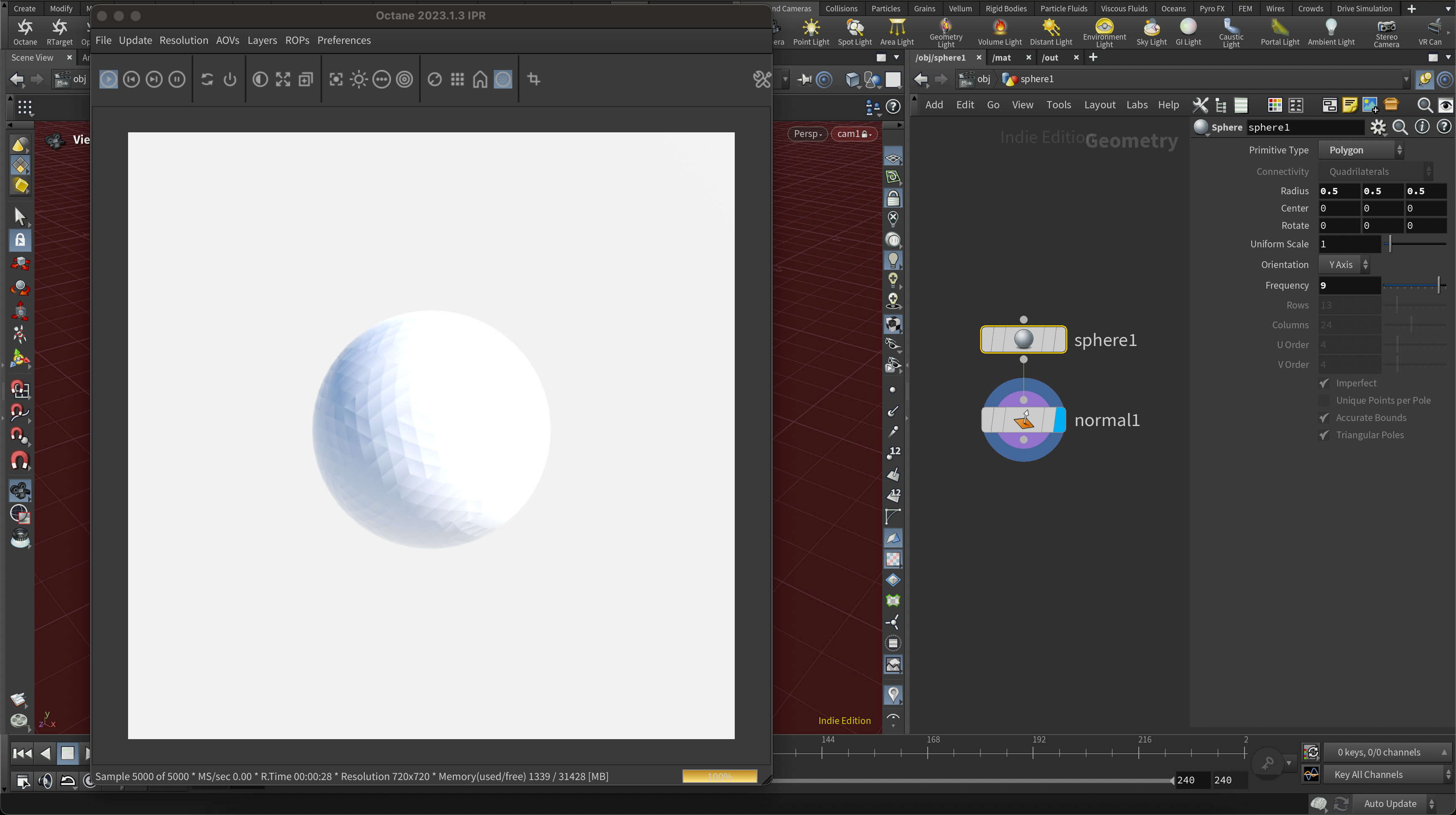

I needed to use octane in obj context and ran into an insurmountable obstacle.
On any geometry when rendering in ipr there is no smoothing - as if there are no normals.
Even subdividing doesn't help. What can it be?
You can see an example on the screenshot.
MacOS 26.5.1, M1 Max, Houdini 21, Octane 2026.3

michaelskripin wrote:I needed to use octane in obj context and ran into an insurmountable obstacle.

Thank you for the post. Would you please share your hip file?
We are unable to replicate the issue. Try the Polygon Mesh mode.
Maybe the scene needs to push the refresh/updateScene button in the IPR button
In the future, please post OctaneRender Houdini-related issues here (viewforum.php?f=103)
to keep the issue/bug tracking easier for us.
