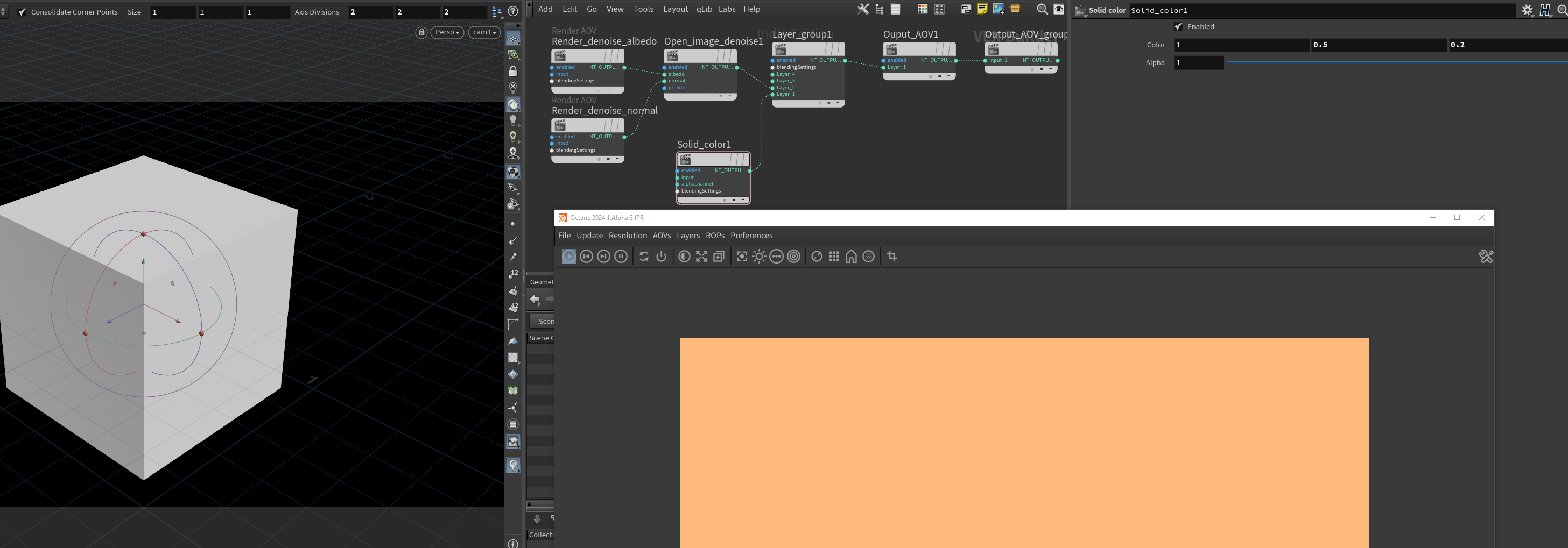

Sorry for the Open Image Denoise problem again, I've followed what's been shown here viewtopic.php?f=102&t=83264&start=20
but it's still not working
The attachment baa119da208c070d216f20dfd51fc53.png is no longer available
I do realize there can be lots of work behind and the document might take extra time to get up to date but it'd be really appreciated if you can provide some example hip files along the new release to show how to use certain new features.
Also I've attached the problematic hip file.

LewisO wrote:Sorry for the Open Image Denoise problem again, I've followed what's been shown here viewtopic.php?f=102&t=83264&start=20
Hi LewisO, it seems to be working, as you can see the solid being rendered. You still need to add AOVs and possibly enable Alpha under Kernel settings.

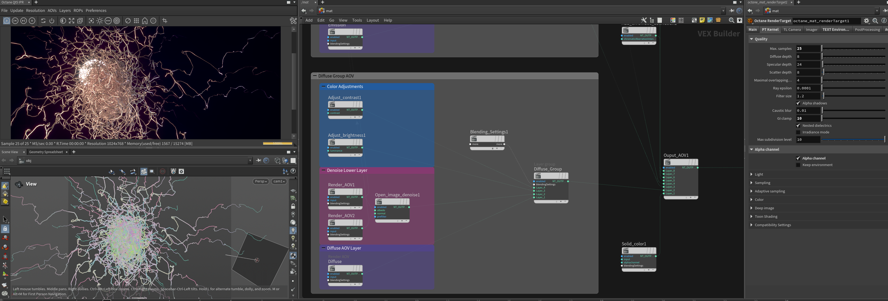

Here is another example and HIP file, it is using 25 samples and denoising 2 separate AOVs, you can scrub in the timeline to see it update.
Make sure you select the OutputAOV first.
OutputAOV.zip
(88.72 KiB) Downloaded 175 times

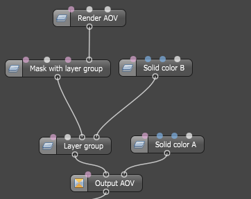

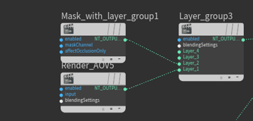

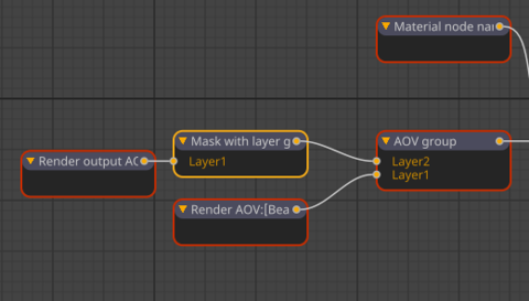

That's another that confuses me, it seems like the nodes are inconsistent across different DCC plugins and the standalone.
As you can see in the standalone and the C4D plugin, you can easily pipe in a color to the Mask with Layer group node, but the color input seems to be missing in Houdini and I can't figure out how to use it like the standalone/C4D plugin
ricky_otoy
Posts: 289
Joined: Mon Jun 19, 2023 6:34 am
LewisO wrote: That's another that confuses me, it seems like the nodes are inconsistent across different DCC plugins and the standalone.
That looks like a bug or oversight, thanks for bringing it to our attention!
