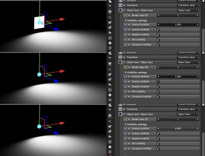

Hi there,
im encountering some strange behaviour regarding the Analytic Lights. So I checked Camera Visibility and General Visiblitiy and the Light is still shown in the viewport. Is it a bug or did I missed something.
Thx

Definitely a bug. We'll fix it! Thanks.
This is also happening with me. I uncheck Camera Visibility. The light geometry does hide from render. But saving and re-opening the file, Camera Visibility goes back to being checked. The odd thing is that in preview render the light still stays hidden until doing a full final render. Very odd and problematic behavior. If one not aware of what is happening can waste a lot of render time if forgetting to double check and fix setting every time you open the file.
This is happening to me on Octane Blender 2025.3 - 30.7 [STABLE] on Windows 10.

I see none of the listed issues with my test scene when using the latest build. Lights are regularly hidden from camera and settings are saved and reloaded correctly.
Can you please share a scene we can use for testing?
Thanks.
Thanks.
