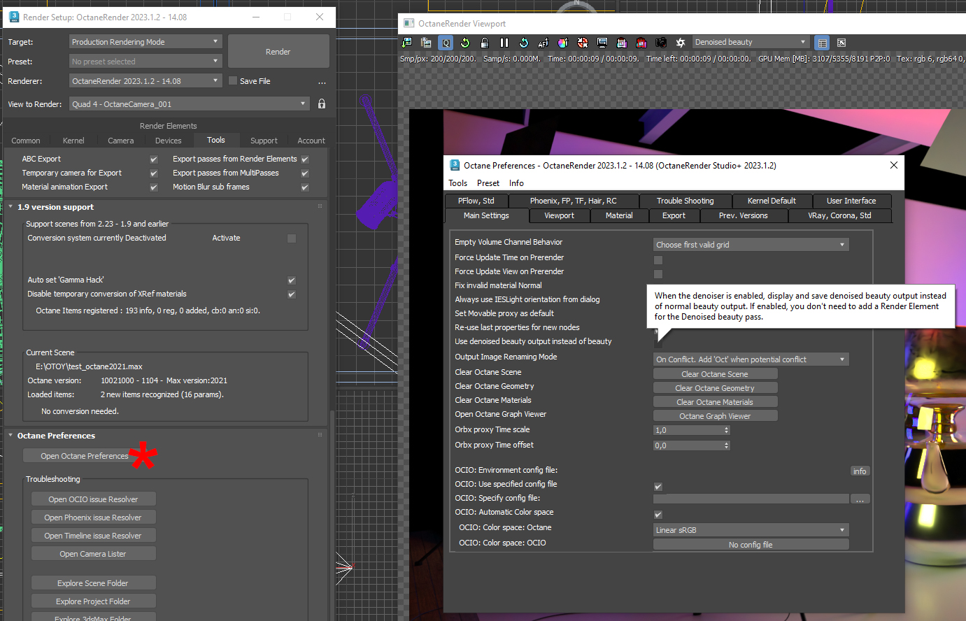

Hi everyone. I love how denoiser works, but it does only if I am saving frame individually through the "save image" button on the realtime viewport. In this case I am getting duplicated image file saved with the same name but __Denoised_beauty added at the and. Denoiser result not applied to the rendered sequence output. I had the same issue with bloom and other camera effects, but it is fixed now after I installed ver 14.08
Please help. Saving the same rendering output duplicated frames but denoised frames could be problem solver.

Looks like no one interested in my problem, and it was not possible to tell me I can output de-noised result as a render element instead of octane passes output, which doesn`t work for me.
Or I am the only one using 3ds max plugin. I hope my solution is useful for anyone

Hi be_fast,
I hope my attached screenshot will help.
Regards
Paride

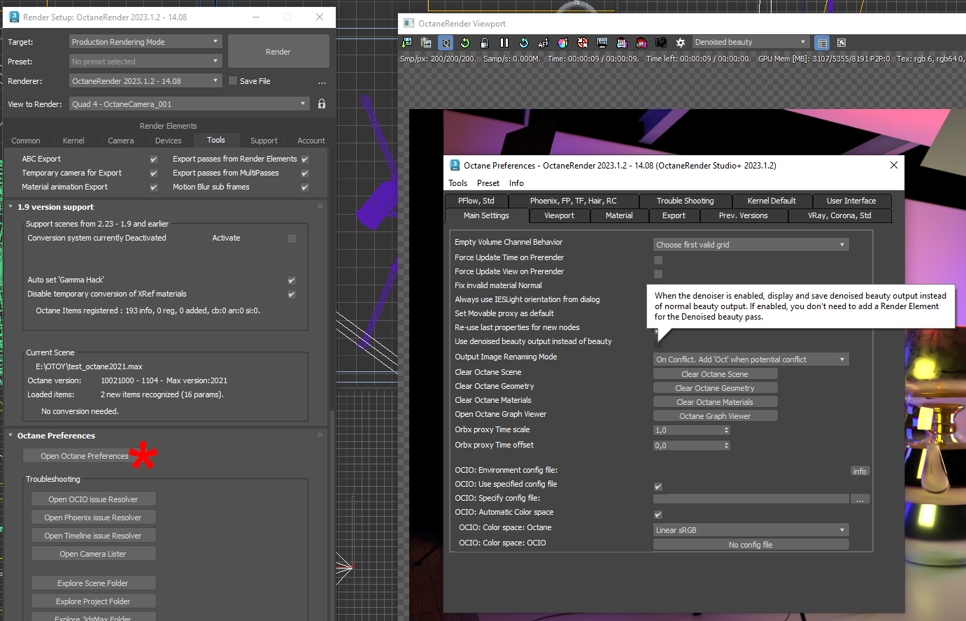

Hi be_fast,
Regards
Paride

paride4331 wrote:Hi be_fast,
Regards
Paride
Yes, thank you very much
