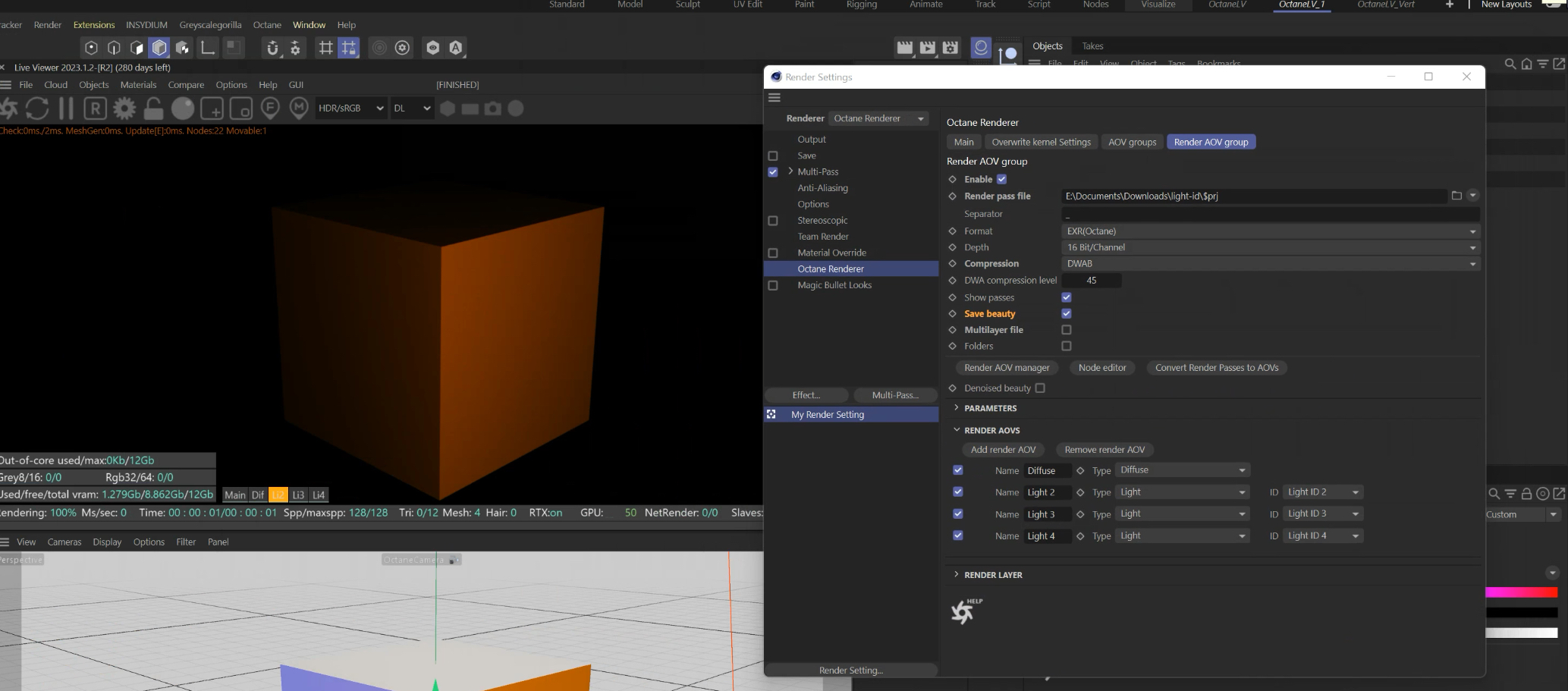

I can not get the Light-Aov's work constantly/reliable in C4D 2024.1.0/Octane 2023 1.2.R2:
- Sometimes (I did my best to find out a more precise specification, without success) the light passes are visible in the Live viewer, sometimes not.
- Even when they seem to work in the Live Viewer, the rendered EXR/PSD-Layers (whatever format) are completely black.
- Other Aov's (i.e. Diffuse) work just fine
Screenshot 2024-01-17 103912.png (6.82 KiB) Viewed 1436 times

just merge the scene into a new empty c4d scene, and rebuild the Render Settings from scratch:
light-id_b.zip
(105.47 KiB) Downloaded 133 times
Please aldo enable the Save Beauty option, and disable the C4D Save option:
It seems that you have an issue with Live View title, please rebuild the c4d layout from scratch, and if not enough, try to delete the oct.dat file at the following path, the c4doctane preferences will be reset to default, and a new oct.dat file will be created on next c4d start:
C:\Users\USERNAME\AppData\Roaming\MAXON\Cinema4D-RXX_RANDOM_CODE\prefs\oct.dat
ciao,
Beppe

Thanks a ton Beppe, could fix it!
