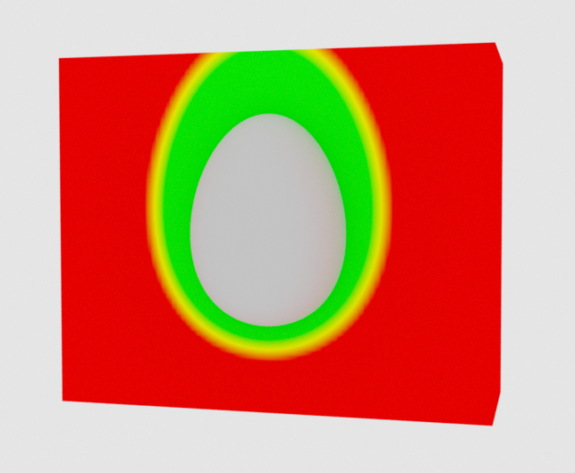

It's been a while since I've seen a post about the shape field node and wanted to see if anyone was having luck with it?

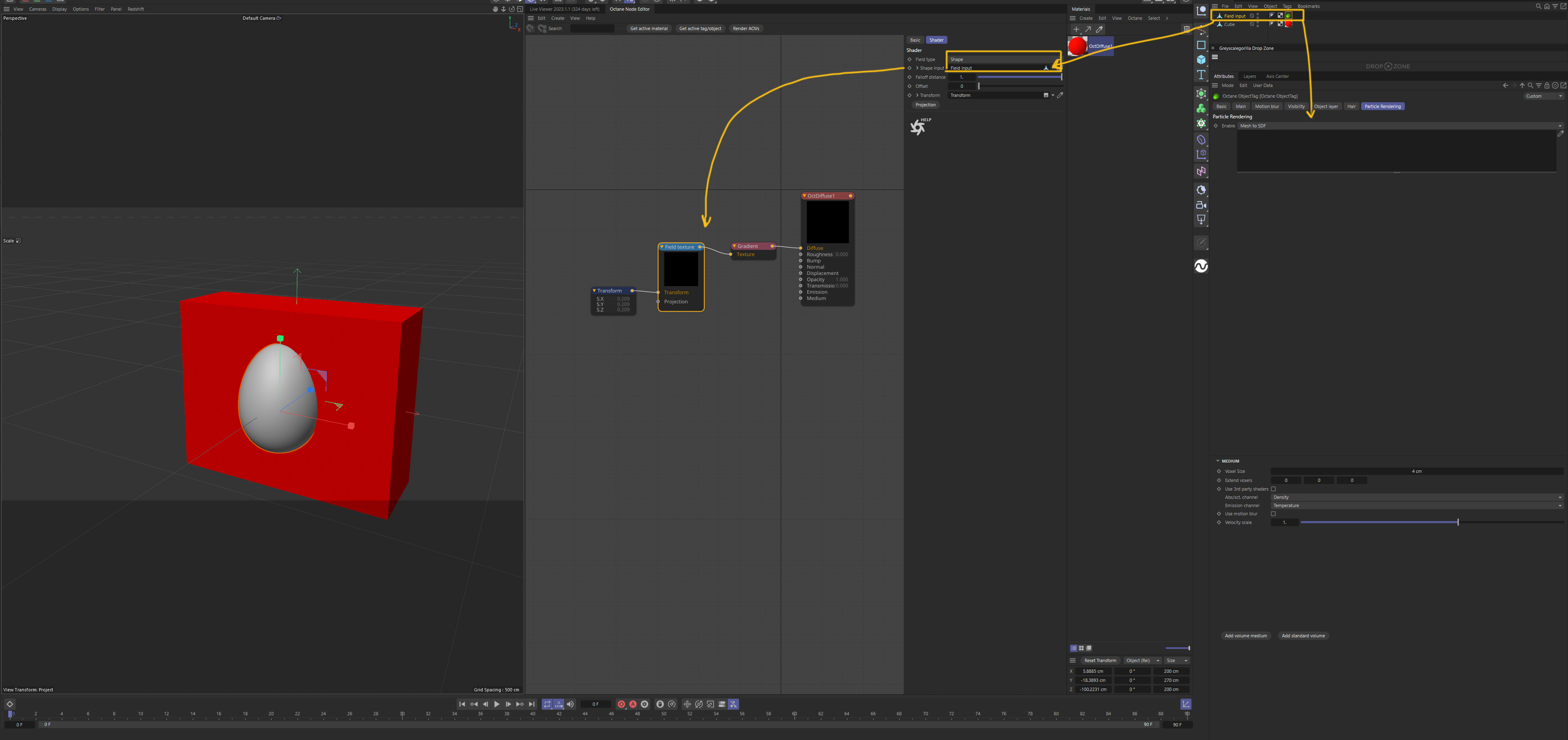

Currently trying to make an SDF with an Octane Object tag set to Mesh to SDF. I then use that SDF as the input for the shape field.
Shape field working?
It works
But remember - you must be very quickly. You have only 10 to 45 seconds for playing with it. After that Octane will freeze. Anyway in Octane 2024 alpha.
