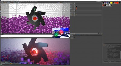

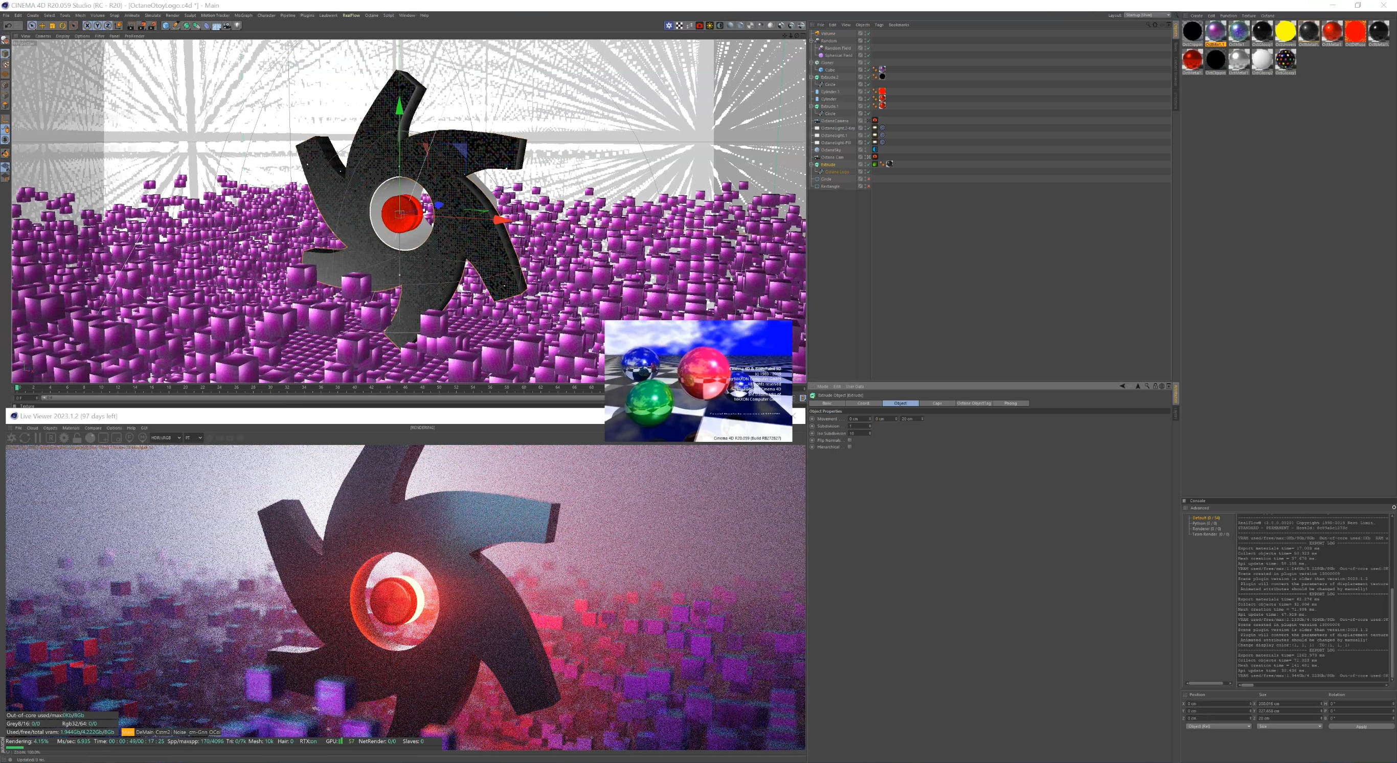

no problems here with c4doctane 2023.1.2 in C4D R20:
Please double check to have not another c4doctane folder somewhere in C4D R20.
