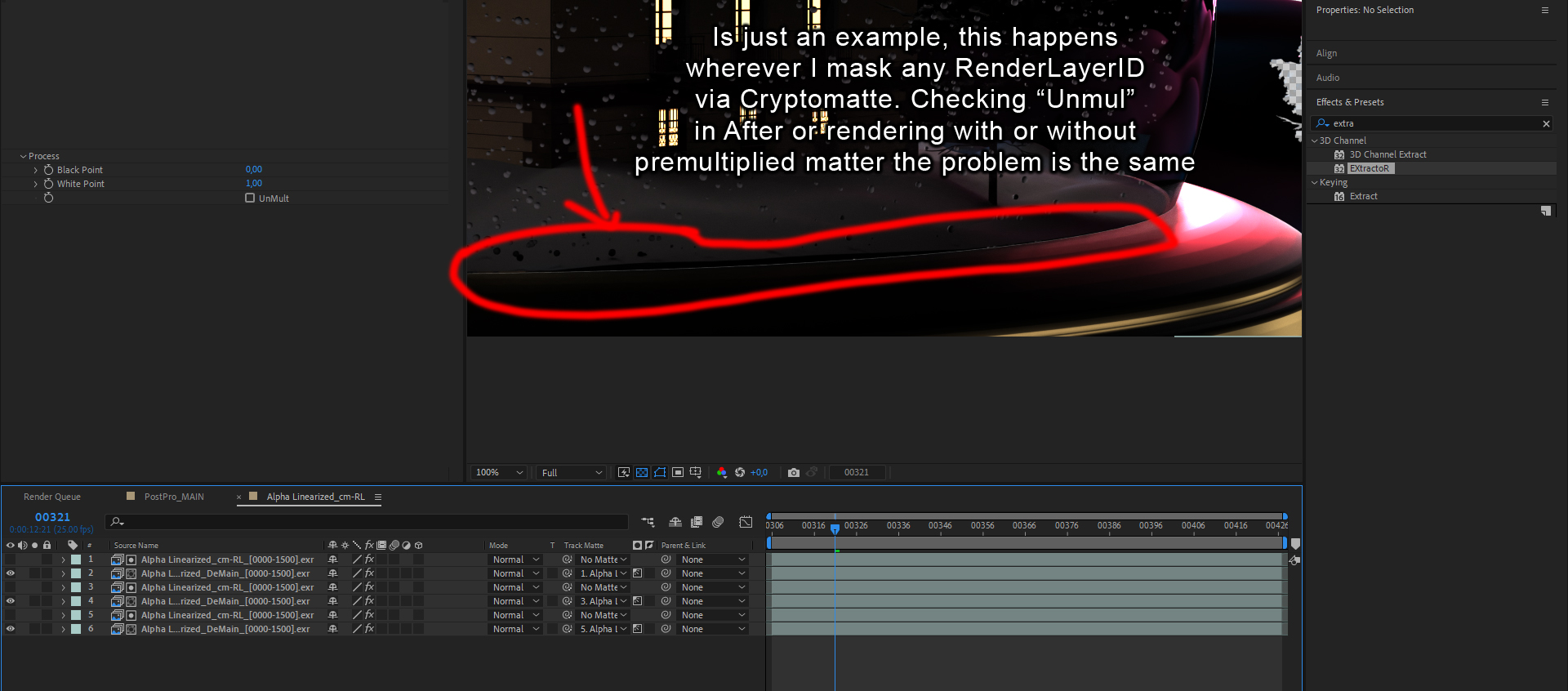

I have rendered cryptomattes with Octane, and when I import the Octane EXRs, I can separate the mats from different layers, but they have a halo around them, and are not perfect. After finishing composition I have a little gap around every object....
Could it be an issue with checking the premultiply box? Are there any specific settings that need to be used? It's crucial that the mattes are accurate; currently, when composing the scene, there are gaps when separating different objects, and I'm using a resolution higher than 3000 pixels wide. I can't find a post that clearly presents a solution to this problem. I would greatly appreciate any kind of assistance, please.

I attach a pic to show whats my problem, yo can see how the cryptomatte dont cut the object properly, always u have this edge. I tried everything, multiplied alpha, raising crypto subds... I´m desperated with this...
I hope I´m missing something, if there is not a way to properly split layers via render passes I have a great problem.
Thank you for the help, appreciated and sorry for my english.

thank you for posting the rendered image.
Please try to uncheck/disable the **Disable partial alpha** from the Imager node and see if it works.

No it doesn´t work. I tried every single option with matte precompose and multiplication, it just looks like a bad behaviour of cryptomatte thing, not in this file but in every single file I´ve checked. This kind of things ruin a work and are really frustrating.

I’m often running into this issue as well. One thing that can sometimes help a bit is applying the ExtractoR filter and clicking the UnMult checkbox. It doesn’t always work but worth trying. And maybe look into your project’s color and linearization settings?
