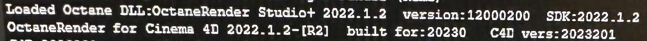

We do network rendering, and I notice that from time to time, network render times become magnitudes longer (like from 30 seconds to 4+ minutes). If I close and restart Cinema4D, network rendering is back to normal. Anything that can be causing this? See attached for the version information. We often batch render after the work day, so if we leave and this happens, it can make is loose valuable rendering time.

Please remove the installed c4doctane version and upgrade to 2022.1.2-R4:
