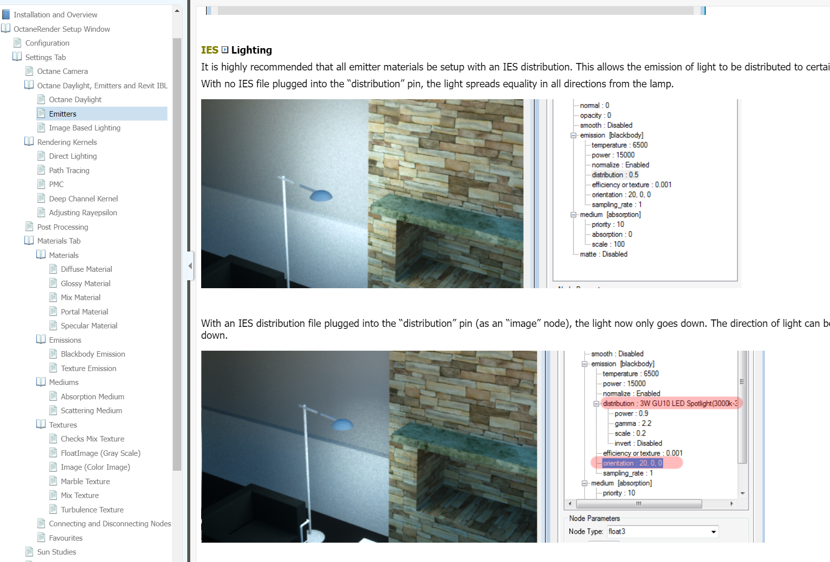

Hi Paul
In the documentation you have mentioned that to control the direction of light from IES file, use "orientation" pin however the plugin doesn't have that pin.
Could you please clarify.
thanks
face_off
Posts: 15827
Location: Adelaide, Australia
Hi - yes, the manual is out of date in this regard. The setup described at viewtopic.php?f=41&t=59870&p=382451 should work for you.
