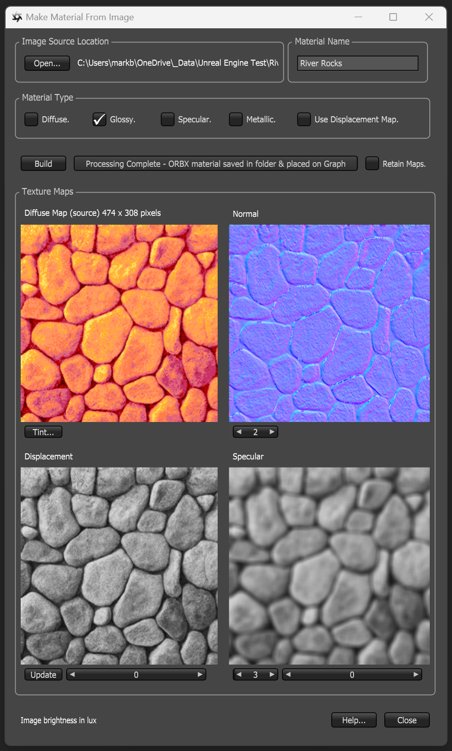

Simple use case
On a slider, or a numeric box with slider active, I would like to trigger an event that updates the app, in this case the contrast of an image in bitmap, (I have others)
utilizing the new slider value on the slider's non-existent mouse up event. In my case it saves having an apply button on the form, and it avoids too much activity.
if it's attached to a value change event. I tried it with value change, and it stacks all the values in a que and applies the contrast algorithm dozens of times to the image which is not good. If i could flush that stack I could work around it.
I recognize there are numerous controls that it does not make sense to have mouse events, a button for instance.
mouse down)
See below, each image can be manipulated before building an orbx material, but I don't want an apply button for each, just update when releasing a slider.
While I'm on this topic, I would like to be apple to zoom to fit these images into the bitmap control, can I do this, at the moment the user only gets
to see the top left image of the diffuse map they import, and likewise with the others that are generated by the script.
Note the 4 bitmap controls and the 3 slider controls used to tweek the normal, displacement and specular maps.
