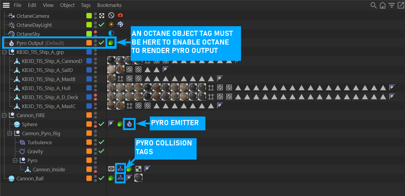

You can use C4D Pyro directly with Octane as well. You do NOT need to output a VDB file, unless you are sending to Standalone or The Render Network. I am including a graphic that shows where to put the appropriate tags. In this example, there is a cannon ball firing from an old pirate cannon. The sphere object is used as the emitter, and the actual cannon ball is used as a collider to displace the smoke.

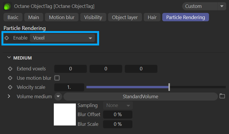

This image shows how to set up the Octane Object tag for the Pyro emitter. Use it with the Standard Volume:
Hope this helps!
