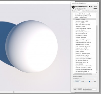

i've tried 16 and 32 bit exr options but any values above 1.0 intensity are clipped to 1.0

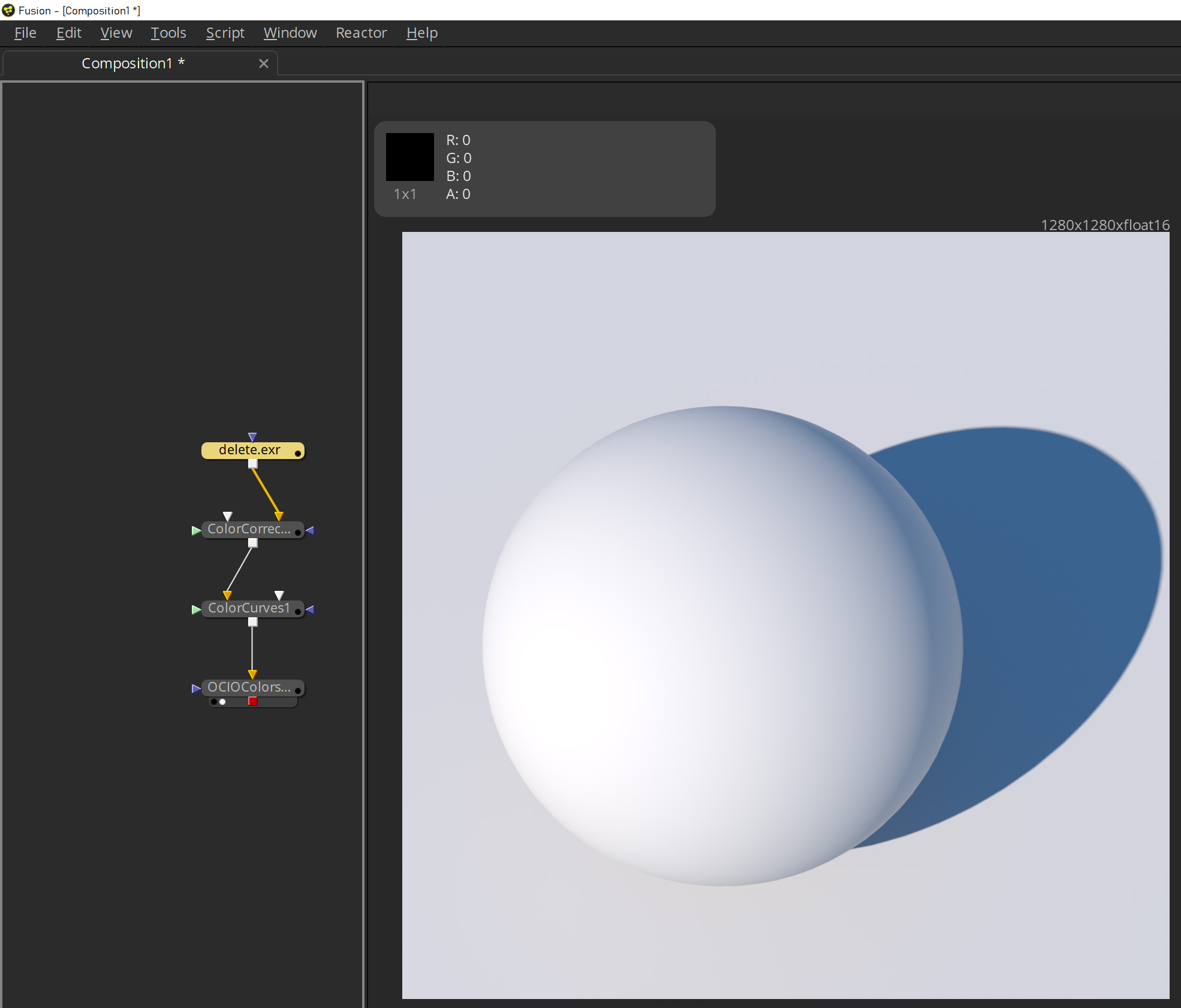

the image isn't linear either it's gamma corrected when i open in Fusion or Affinity Photo
the same image exported from MODO works as expected

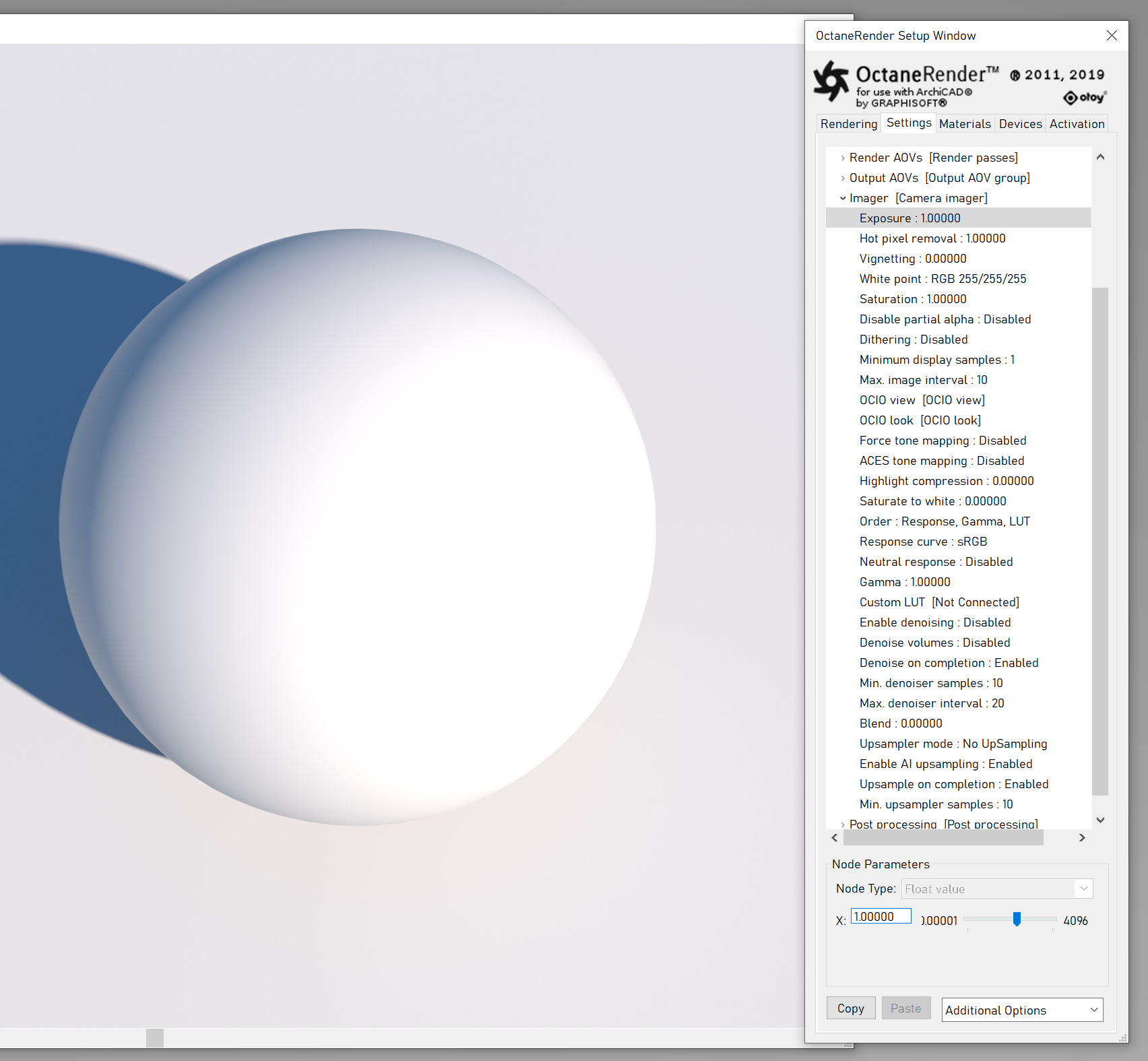

ACES/Force Tonemapping/Highlight Compression all disabled
is it working for you?

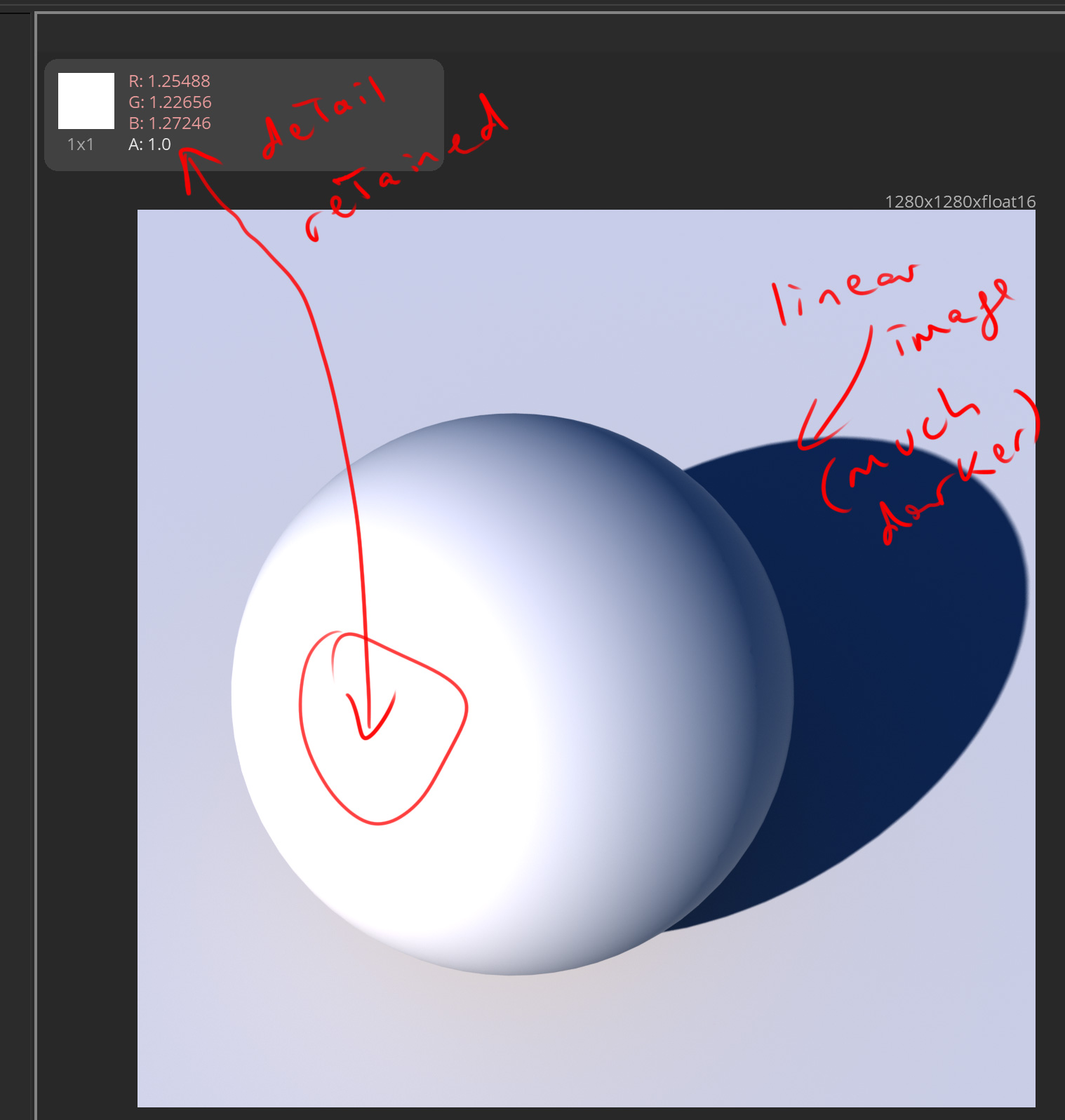

same process but rendered in MODO:

For reference, saving an EXR saves with the following settings:
- sRGB color space
- No pre-multipled alpha
- Zlib compression, in blocks of 16 scan lines (lossless)
- Compression level of 45
There is an option to save as "The sRGB color space with a linear transfer function." (ie. Linear) - however that would apply to all saving of EXR's. Linear is potentially the better default for EXR's. Let me know if you would prefer that.

elsksa wrote:I don't know where that EXR has been loaded to be viewed.
Has it been conformed to display output? From Linear-sRGB to non-linear sRGB?
A linear-sRGB EXR is not supposed to be viewed without a conformation to a given output destination.
thanks
i understand that a linear EXR is not supposed to be viewed natively. i was showing the linear image to point out the difference vs the tonemapped Archicad output
i should add that i wrote "the image is rendered in MODO" but of course i meant Octane for MODO
the post processing app is Fusion Studio. my usual workflow is very simple - export a float 16bit linear EXR and tonemap as required
same image from above tonemapped:

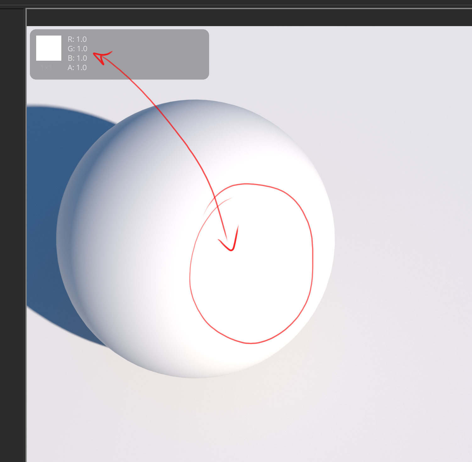

had a go with this but there are still issues
the image seems to be saved linear, but max white values are clipped at 1.0 (they should go beyond 1.0)
also, tonemapping is saved. with linear workflow the image should be saved without tonemapping (unless Force Tonemapping is selected)
