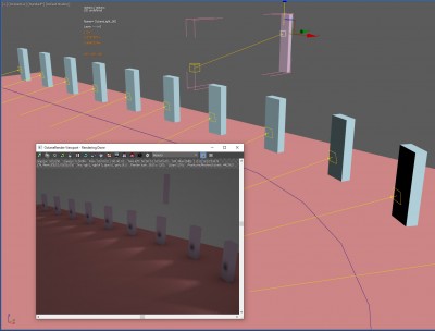

I used itoo Forest to clone a group with a light in it.
The mesh of the light make a shadow in the cloned objects, not in original one.
could it be resolved ?
File is joined. ( max 2022 - OctaneRender® for 3ds max® v2022.1.1 - 13.20 )

HHbomb wrote:Hi,
I think it is octane bug. Even when light is set to invisible it leaves shadow and reflection

apart from Fp problem, if you want your mesh don't create shadow select it and in "octane object properties" window , set Visibility=0

Thank you. That one worked. I never had to do this to lights in octane before.
