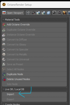

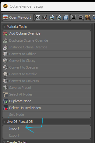

is it possible that the LocalDb specific Folder for the LocalDB via Modo is bugged ?
If i click the [Live DB/ Local DB] > [Import] insinde Modo Octane-View it opens a different Folder from what i set in System> Prference> Octane> LiveDB
It Links to Users\xxx\AppData\Roaming\OctaneRender\localDb // Preference is set to: "D:\_assets\material_octane"

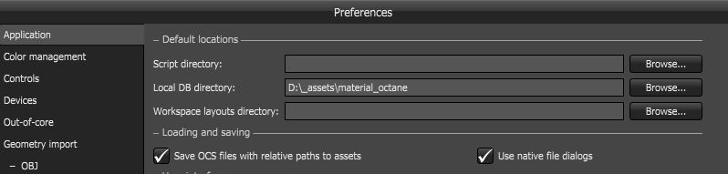

in Octane Standalone it is set to "D:\_assets\material_octane" as well and works as aspected.

Import Button inside Modo

Octane Standalone Path

The plugin LiveDb Texturemaps Folder is the folder where LiveDb texturemaps are unpacked and stored.
The LocalDb folder is where the Octane LocalDb material are stored. The LocalDb window is a popup generated from within the Octane SDK, so I have queried OTOY on how to change the folder. I will report back here when I hear more.
