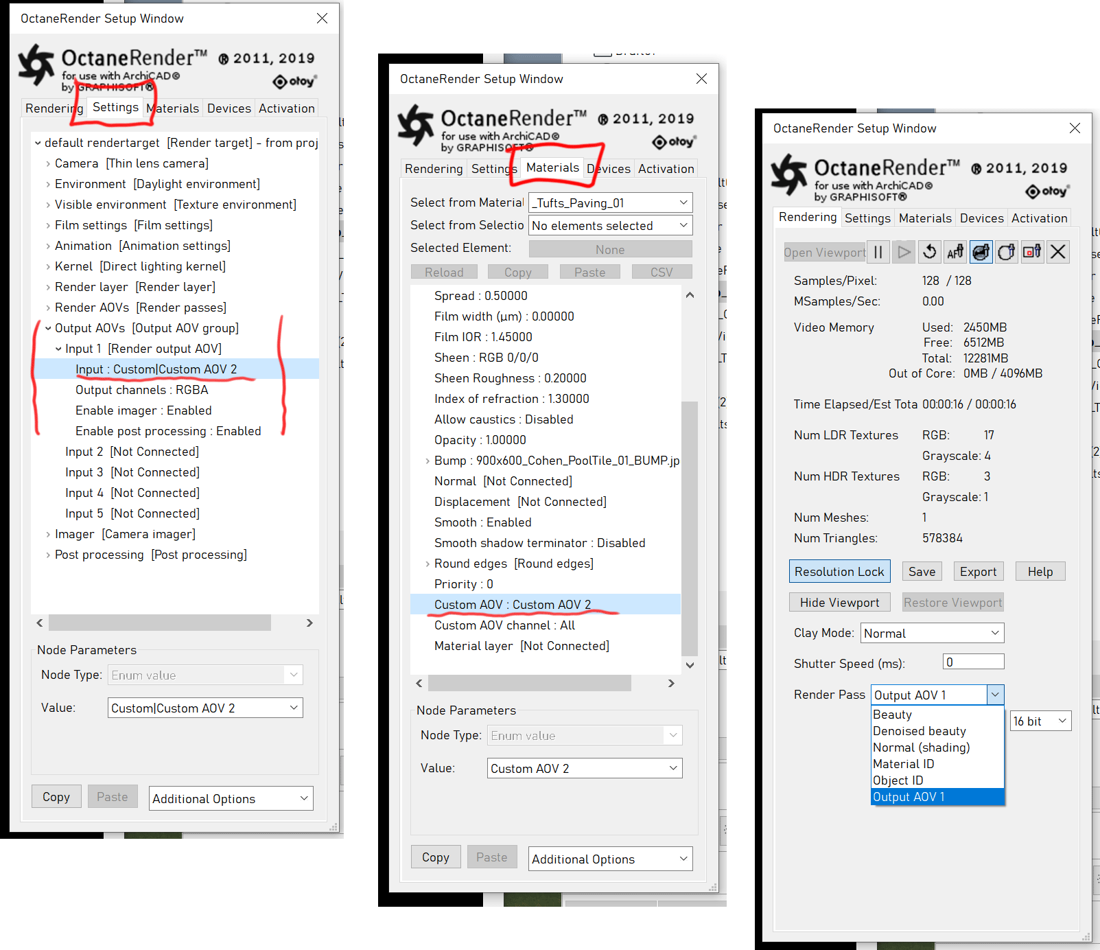

struggling to get this working in AC - what am i doing wrong?
in the Settings tab i enable 'Output AOV Group' then in Input 1 i select 'Render Output AOV' and in its own input i select 'Custom AOV 2'
in the Material settings i enable 'Custom AOV 2'
in the Rendering tab there is only a 'Output AOV 1' available and no 'Custom AOV 2'
the output is all black

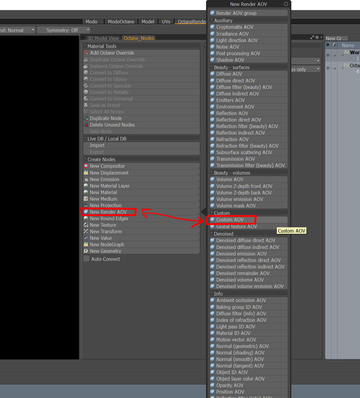

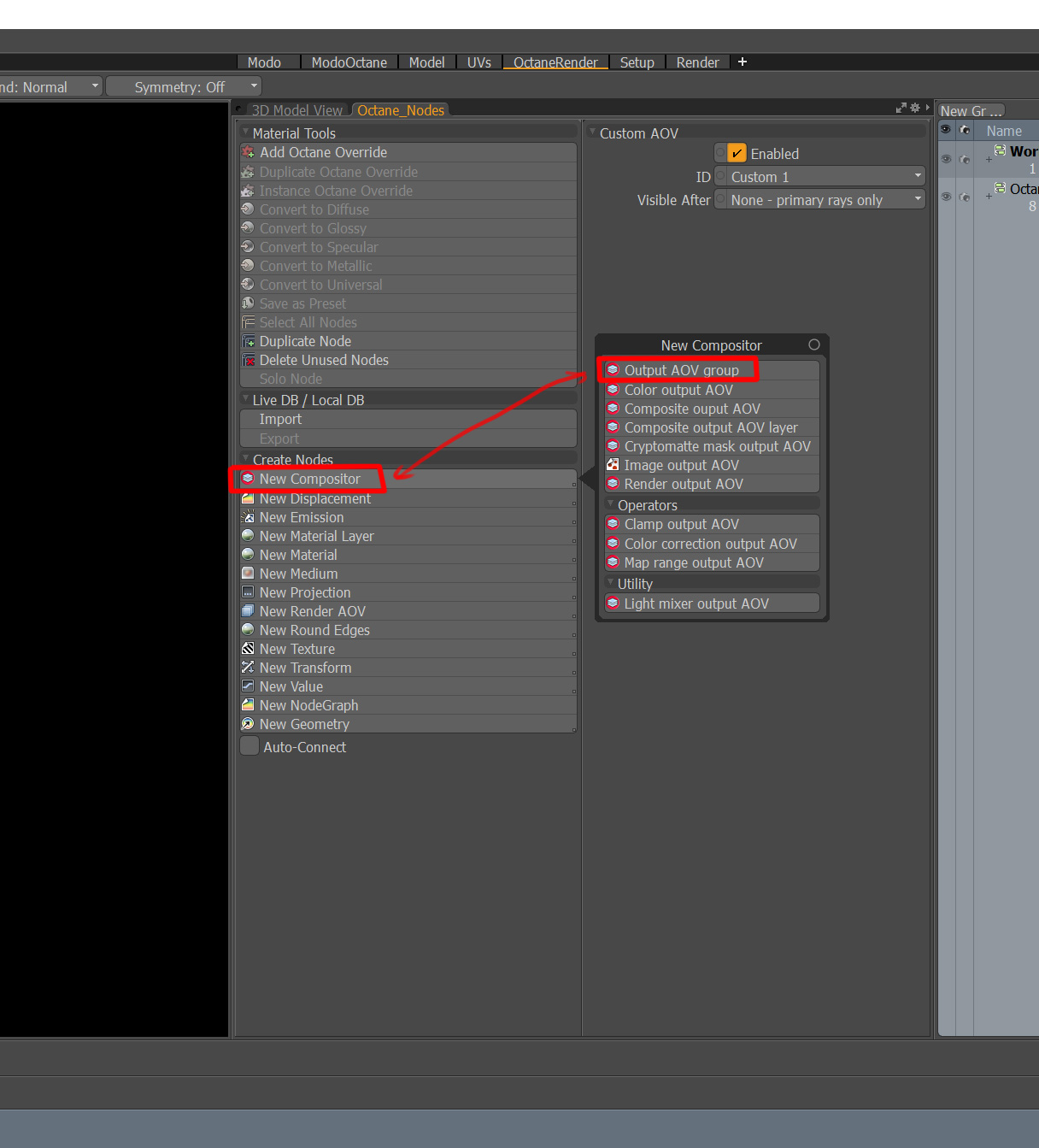

i'm not sure but i think the Render AOV's are missing from the list?
the Output AOV's i believe are for use with the Compositor, or at least that's how it is in MODO?
i have to say they must have tried /really/ hard to get the naming as confusing as it is

sorry i meant to say that Custom AOVs are missing in the Render AOVs... in Archicad
in MODO you can choose Custom AOVs in both Render AOVs and Output AOVs
in AC, i only see Custom AOVs available in the Output AOVs section

Dingbat wrote:sorry i meant to say that Custom AOVs are missing in the Render AOVs... in Archicad
Thanks - I will make sure these are in the 2023.1 version of the plugin (which contains a new AOV system).
