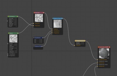

Dear Octane People,
i am working on a scene where i want to utilize the curvature node in conjunction with a noise map to drive the displacement in a composite shader.

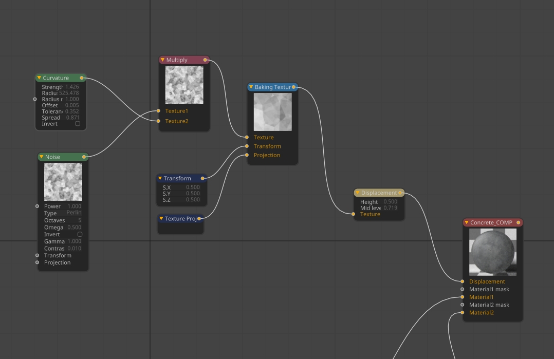

I am aware that i need to use the Baking Texture when using texture displacement, so i went ahead and did that - however, it seems that the baking texture is not picking up the curvature/multiply setup that i have:
Is there a limitation that i am unaware of, where the output of a multiply or curvature node can not be baked or used for displacement? Or is my setup simply flawed?

Posts: 10616
geometry texture nodes, like Curvature or Dirt, are not working with Baking Texture.
Have you tried with Vertex Displacement, instead of Texture Displacement?
