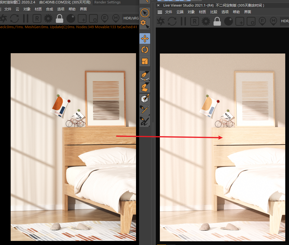

I made the project in OC2020 before, the same project, now after opening in OC2021, the color of the preview window is white, how can I restore the normal color?

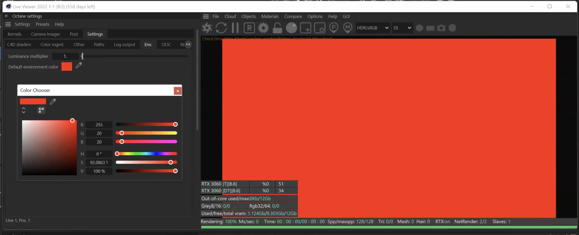

if you are using the c4doctane plugin, you need to go to c4doctane Settings/Env tab, to personalize the default Environment color:

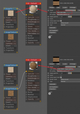

Thanks for your reply, my problem is actually: for example, in my OC2020 project, the color of the wood panel is normal, but when I open the same project in OC2021, the color of the wood panel turns white.

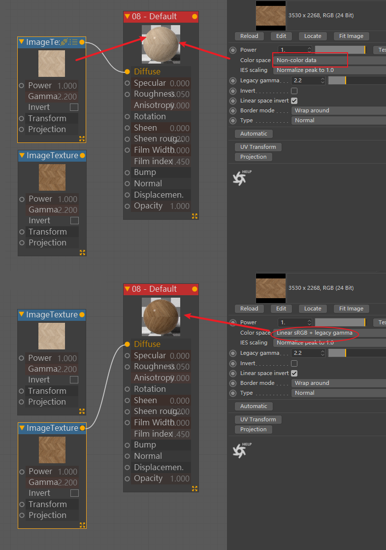

Yes, from 2021.1 it is possible to specify the Color Space for each texture. You need to go Live View menu materials/Octane Texture manager, and check that the Color Space is not set to No-color data, then change it to Linear sRGB-Legacy Gamma.
in 2021.1 there is also a new White Light Spectrum menu in the kernel panel, and by default is set to D65.
You need to switch to Legacy/Flat to have the same result as before:
ciao,
Beppe

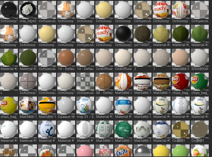

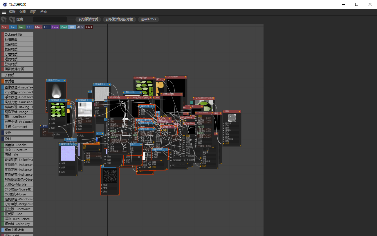

Thank you for your reply. I have tried to make bulk modifications like this, but as shown in the picture, the interface will be messy, with at most a few shaders to modify, which will take a long time. Unable to modify with one click.
