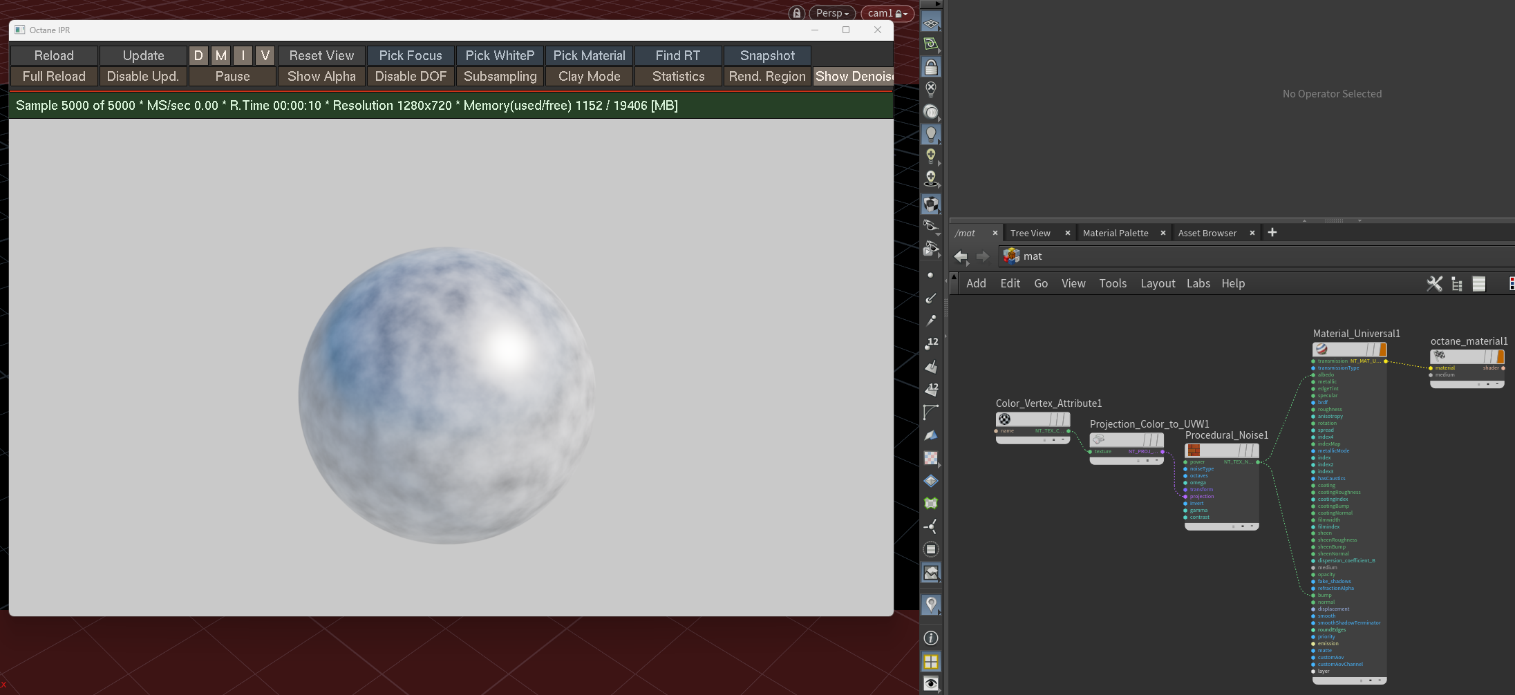

When using projection color to uvw connected to a procedural noise it works fine when the output is plugged into albedo, but when connected to bump, it doesn't do anything.
Attaching a sample scene.

I think that right now, once you connect a node including vertex attributes to the bump input, the bump doesn't work, probably because the core can't compute the right shading derivates information for bump/normal mapping from vertex data. I don't know the details, but it sounds like this kind of limitation that other renderers also have.
-Juanjo
