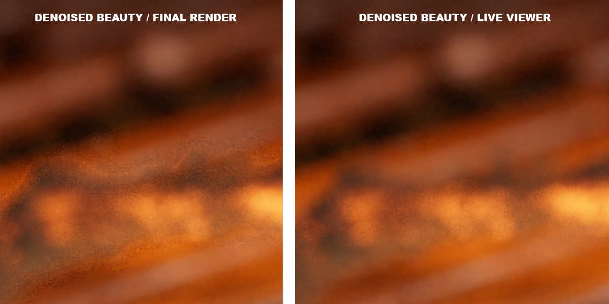

Hello everyone,
I'm having some problems with my latest project, I'm using the latest version of Octane and Cinema 4D R2023.

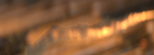

In my scene I have a VDB Fire, but in my final render (Denoised beauty) I get some weird artifacts on the out of focus VDB, but only in the final image and not on the live viewer.
I've attachen an image comparison between the final render and the live viewer. I'm exporting Octane EXR using ACESsg, Denoise volumes active, Path tracing.
I've tryed everything, but I can get rid of those artifacts, please help me.
Thank you very much for your support.
Nik

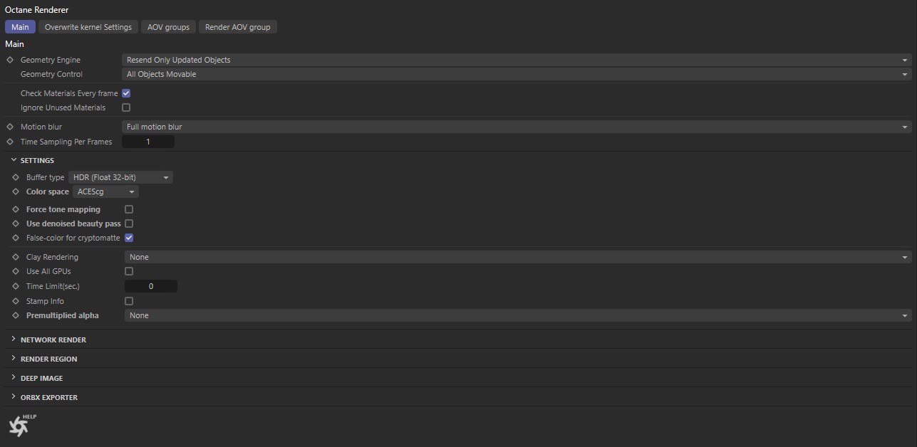

Hi Nik,

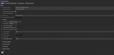

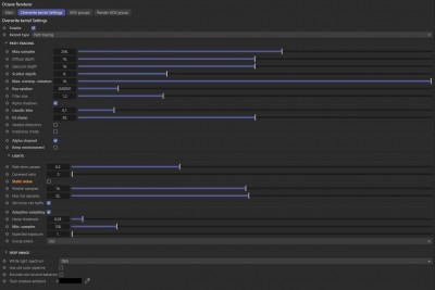

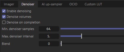

this is not expected, can you share a screenshot from Render Settings/OctaneRender/main tab, and Render AOV group tab?

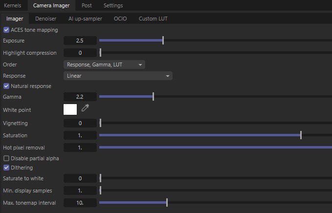

Ciao Beppe,
Attached what you requested.
Thank you
Nik

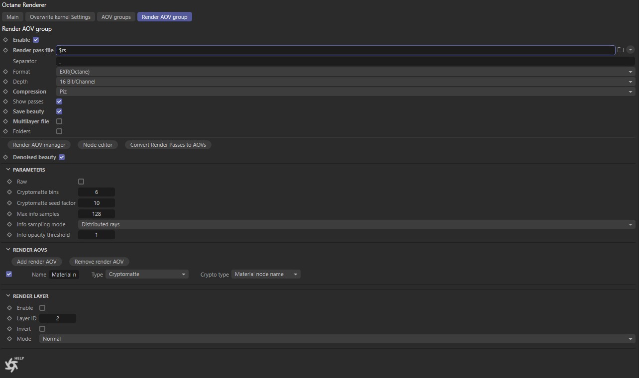

Posts: 10614
Thanks for sharing the screenshots.

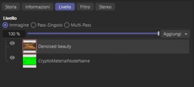

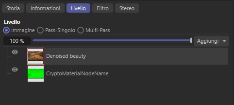

Since Denoiser is saved in a separated AOV pass, could you also share a screenshot from Picture Viewer, Layer tab, to check if Denoided beauty pass is correct or not?
Not related to the issue, but, you should always keep the Denoise on completion option enabled, or the rendering time is longer, since denoiser is calculated at each max samples interval.

bepeg4d wrote:Thanks for sharing the screenshots.
ciao,
Beppe
Ciao Beppe,
Thanx for the tip of "denoise on completion", I thought that option was only related to the live viewer.
I've attached the screenshot.
Thanx

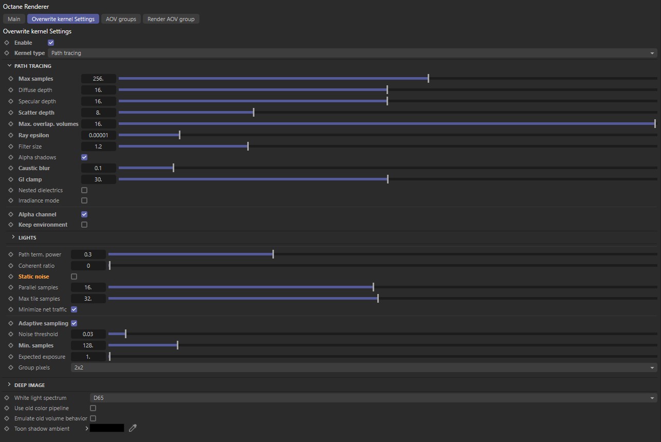

Posts: 10614
Ok, thanks.
what happens if you disable the Overwrite Kernel Settings option in Render Settings/OctaneRender/ tab?
ciao,
Beppe

bepeg4d wrote:Ok, thanks.
ciao,
Beppe
Just tried, same thing.
Thanx
Nik
