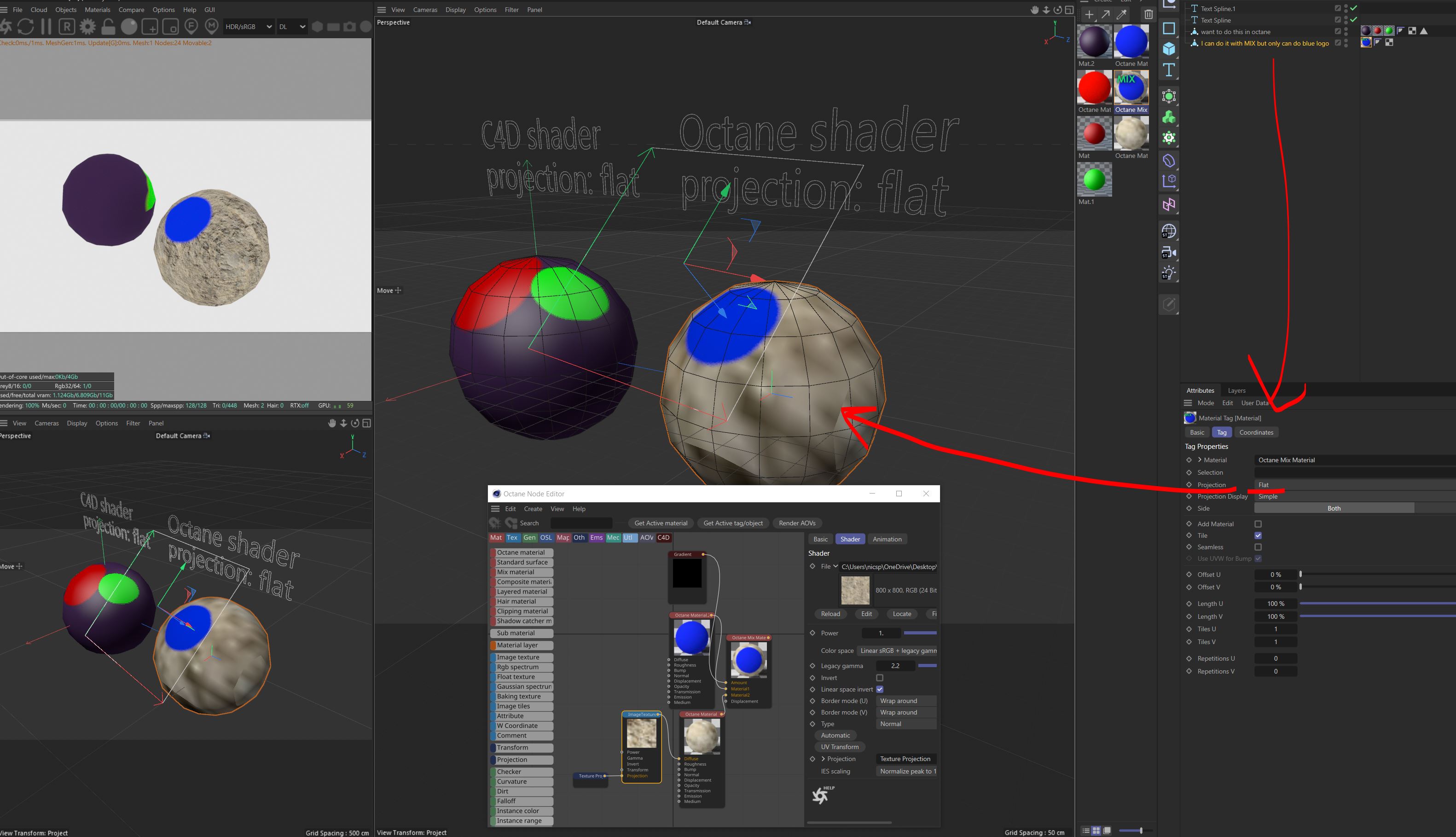

Hello,
Is this a bug not yet fix? both C4D shader & Octane shader does not work.
I use a projection "flat" on a sphere with a c4d gradient to project on a sphere, both render show missing red circular.
The viewport for octane shader does not update also.
Can this be fix?
Best regards,
Nicholas

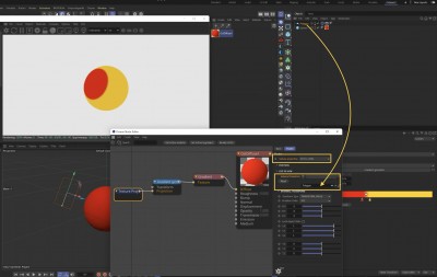

Posts: 10643
here is how you can do it in c4doctane Node editor, without changing C4D projection, and by using an external object to move the gradient where you want:
OctaneFlatProjection.zip
(128.96 KiB) Downloaded 76 times

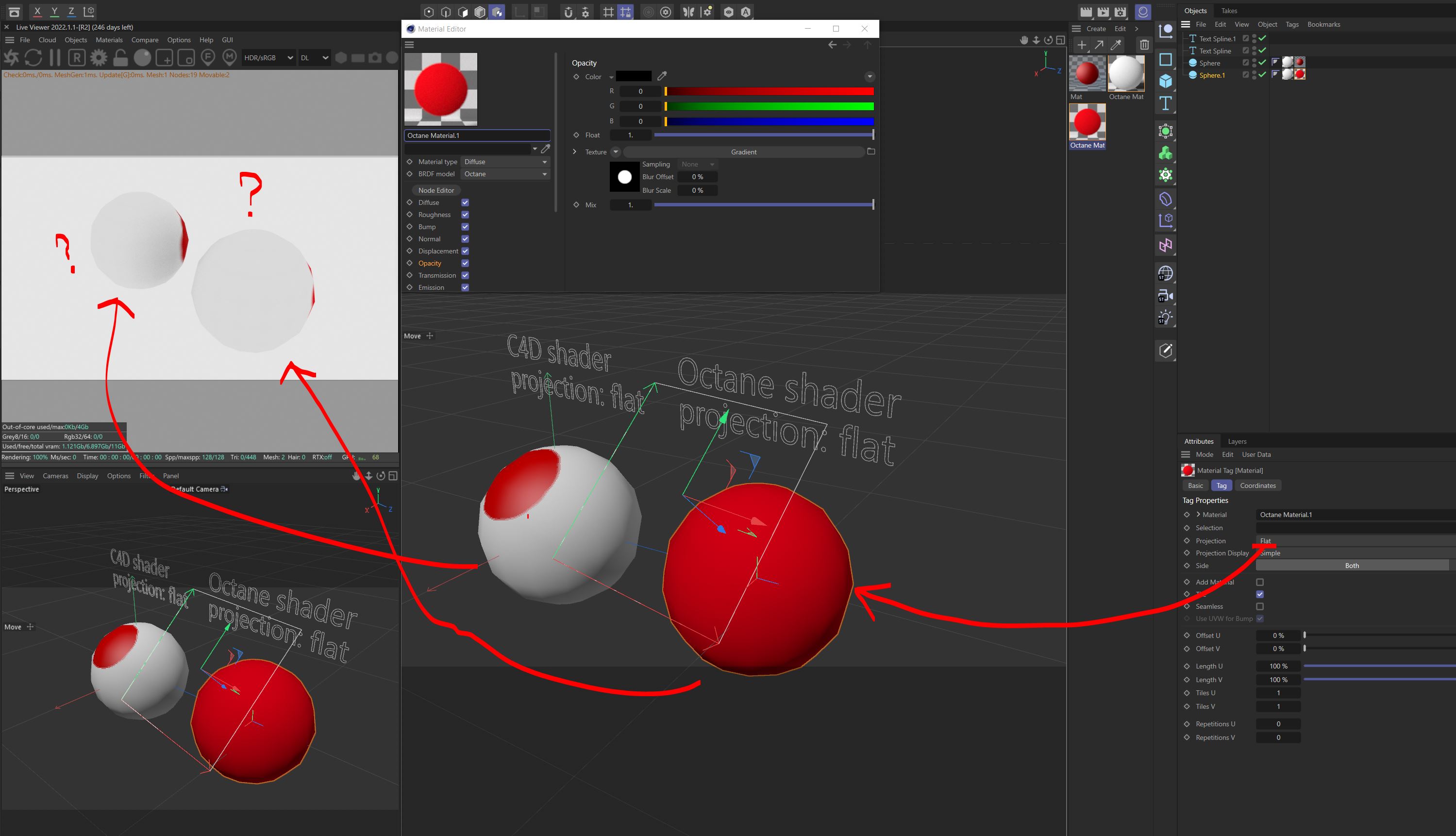

What about the staking shader tag on object manager, will that be fix soon?
my purpose of this is, to put on multiple logos on a product. So I use multiple sharder tags.
When I got 2 logos, I use extra 2 shader tags to overlay the master shader tag on the object manager. Will this be fix?
Projection.zip
