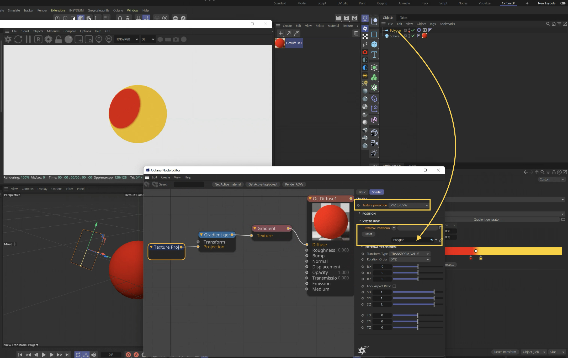

here is how you can do it in c4doctane Node editor, without changing C4D projection, and by using an external object to move the gradient where you want: ciao,
Beppe
Beppe
