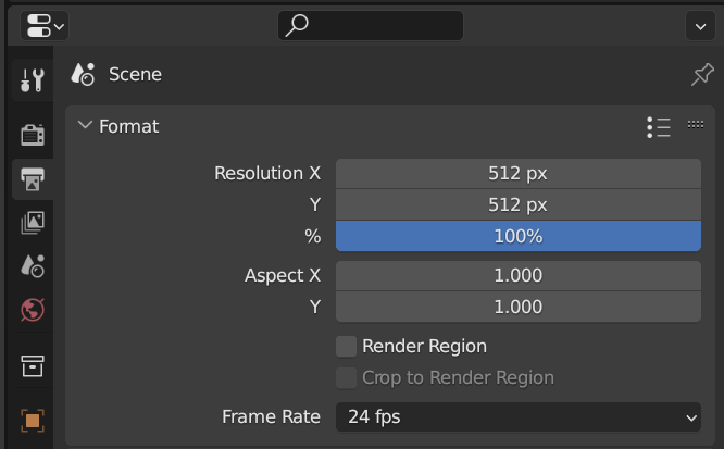

I have set the Render resolution to the projected image resolution:
It looks different, but not like the camera view.

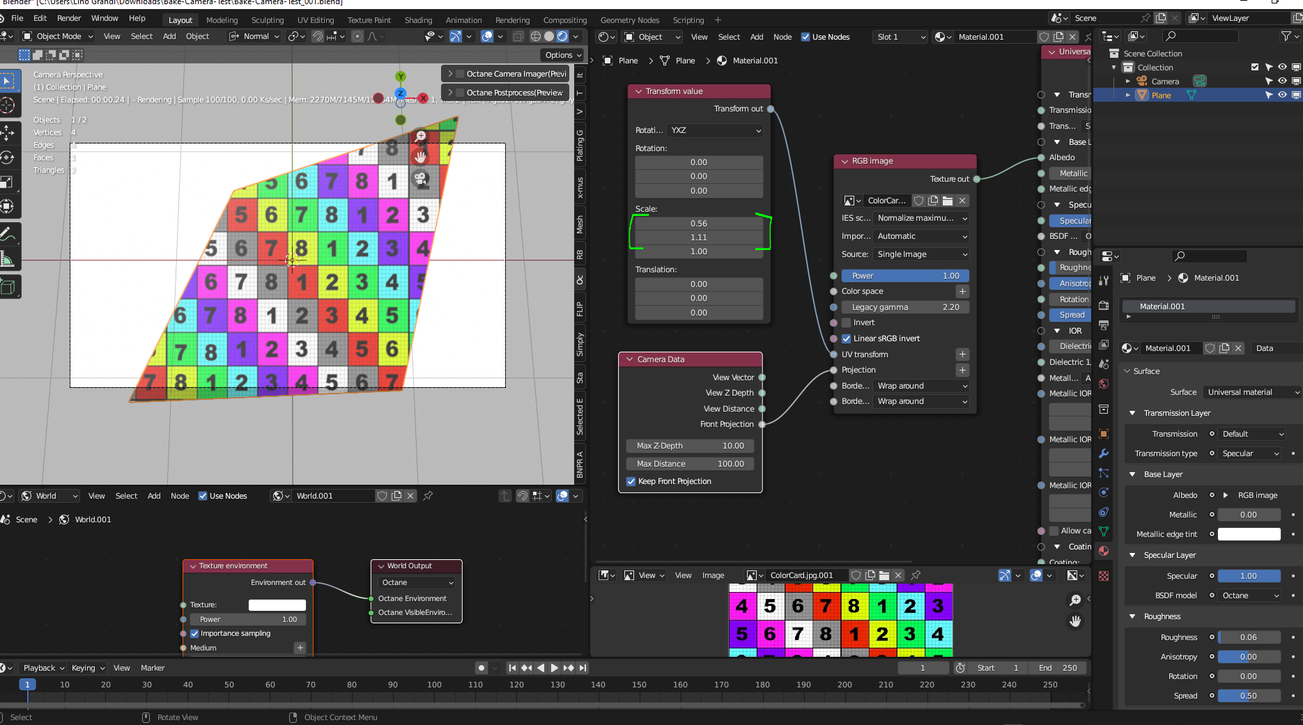

That's all you need to do:
The X and Y scale control the aspect ratio of your image.
