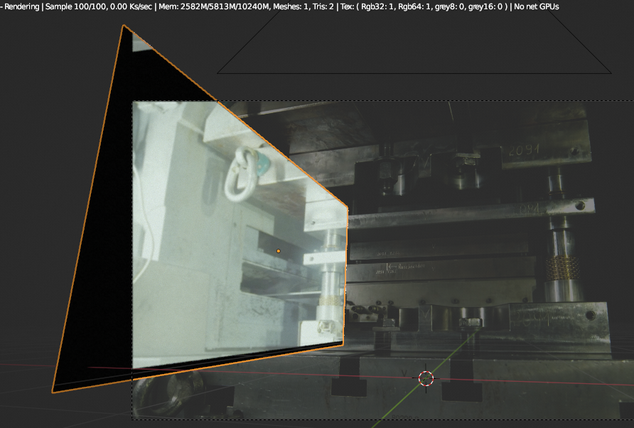

with the camera bake I get the result that you can see in the attached image.
I have no idea, how I can get the rendered film image in a texture image file for the plane.

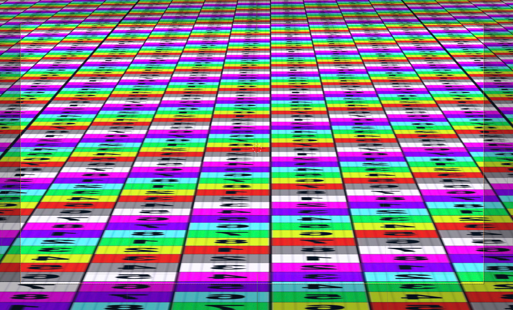

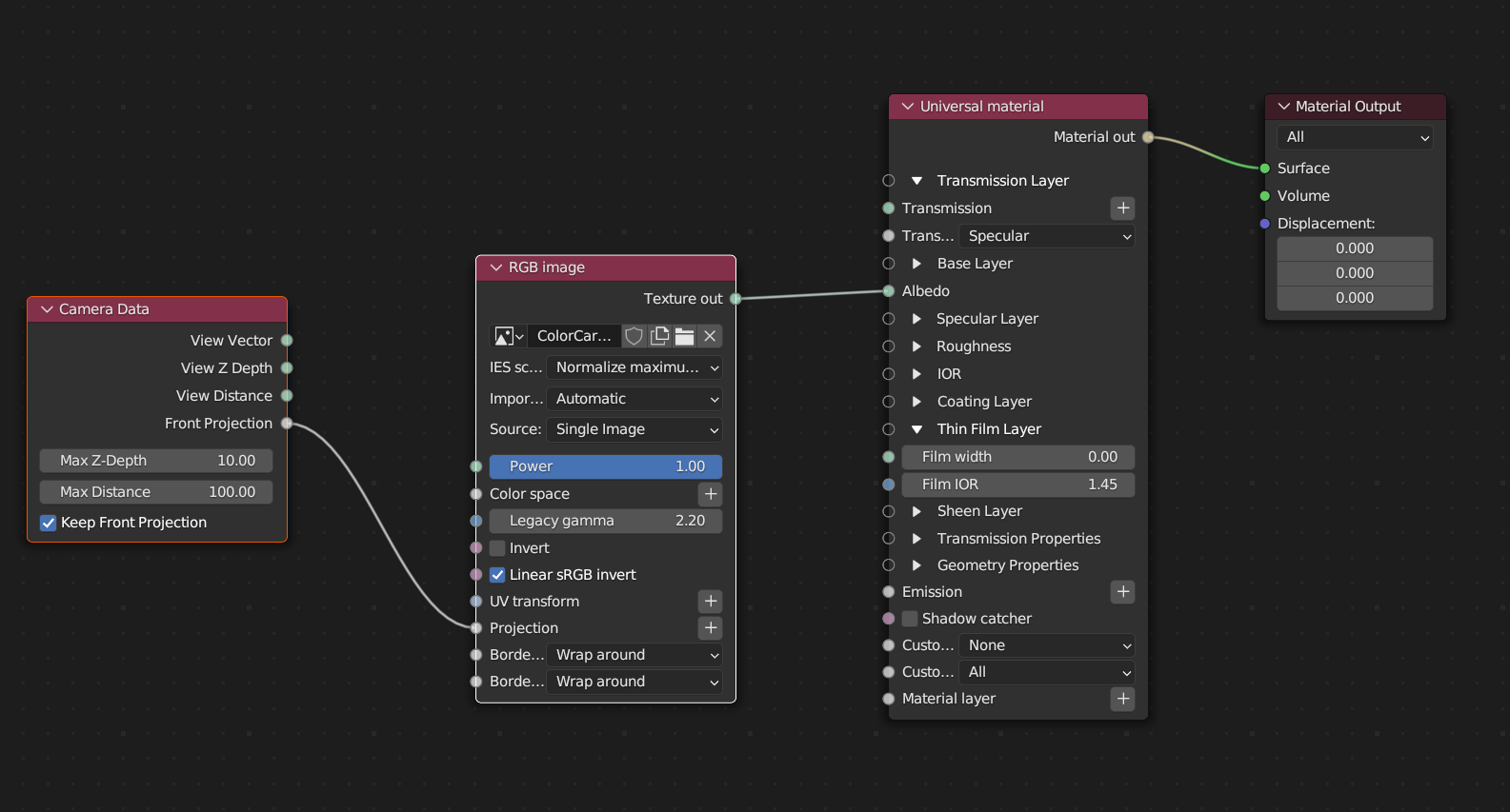

I project a UV-Color map in the material with camera data node.
material in the shader editor
when I look through the camera it looks like this:
Camera-Projection result
Here you can see the Scene setting. But you see the camera projection is now projected by the viewport camera.
Camera projection dont change, but viewer cam project the map
If I bake it with camera bake option the result is not the same like you can see through the cam.
Baking Result
Baking Result
Please help :| if you can

Is the resolution of the images you're using for front projection the same you're using in the new render? That's important.
If that's not the case, you'll have to use a Tranform Node and change the size values so they match the different resolution/ratio.

linograndiotoy
Posts: 1532
That's all you need to do:
The X and Y scale control the aspect ratio of your image.
