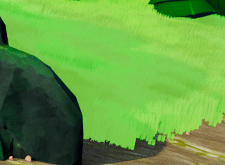

Maybe Someone here can help me out. We are starting a new project going in a handpainted/cartoon/simple shading look. Therefore I need the look of "constant shading" from the viewport, like you can see in the attached pciture 1.

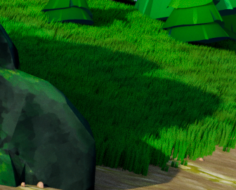

I can almsot 100% mimic the effect by simple using a texture emission node with surface brightness on and a value of 1 or 2. Disabling all the shadow options helps as well. The problem is: it influences the shadows on this objects of course.

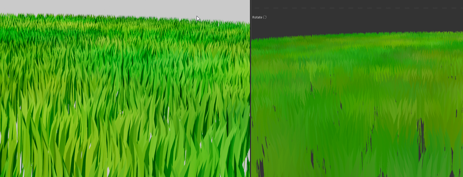

See picture 2 where the look is right and picture 3 where the shadow is right. I would need a combination of those two.

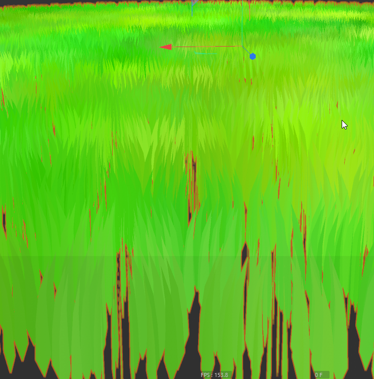

Does anybody have an idea how to achieve it in octane? The last picture shows again what I need (right) and what I get (left)

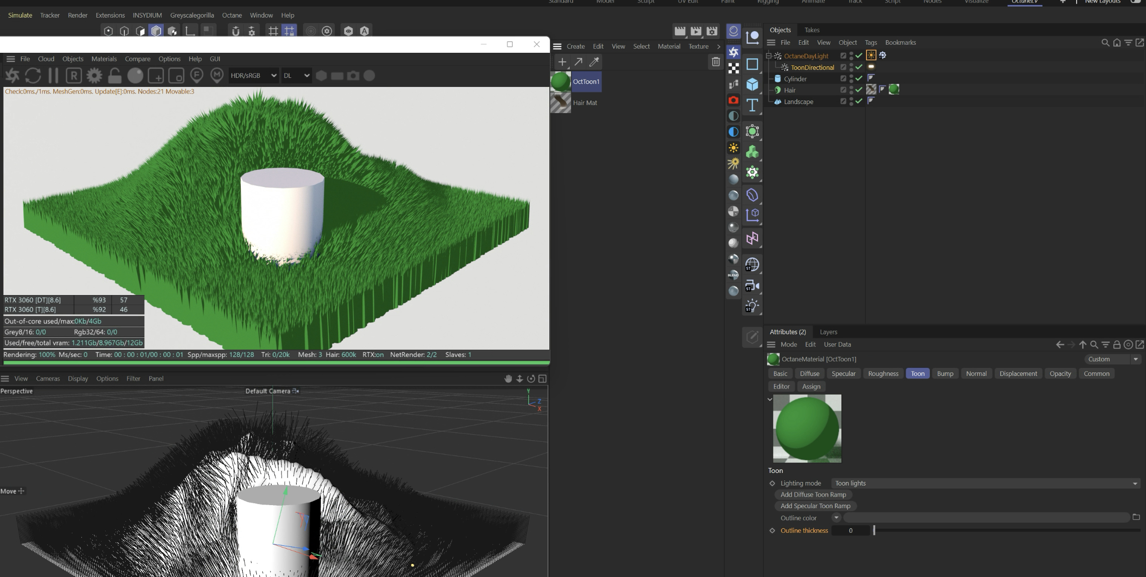

What about using a Toon material with 0 line thickness?
You need to add a Toon Directional light as a child of the DayLight Environment.

Thought of this as well but you still get shadows of the leaves itself. By using emission you can almost get completely rid of them, but other shadows as well.
