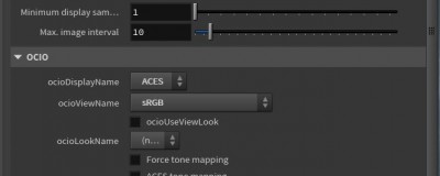

yes the settings didn`t change... and settings are in the screenshot.

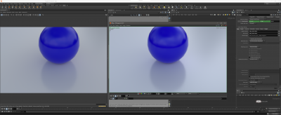

also i attached an example render where the difference is visible...
right: Mplay image with enable OpenColorIO deactivated, with rendering of Octane2021
left: IPR Octane 2022 - darker than right

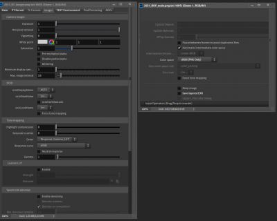

left: IPR Octane 2021 - which is matching obviously.

Sorry, I'm not an expert in color correction at all, but I think that to export sRGB png files you should select the OCIO sRGB config in the render target node to let the IPR preview math the output file.

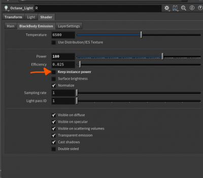

a late followup,
i found the reason for my scene beeing darker in Octane 2022 as i found out that my problem is not colour-space or alikes but the keepInstancePower checkbox that was added to OctaneLights in 2022, and is on by default.
So opening a file built with a previous version, and using scaled Grid-Lights (surface brightness unchecked) leads to a quite different scene lighting... but is easily fixable by unticking this checkbox on all scaled lights unsed in the scene...
