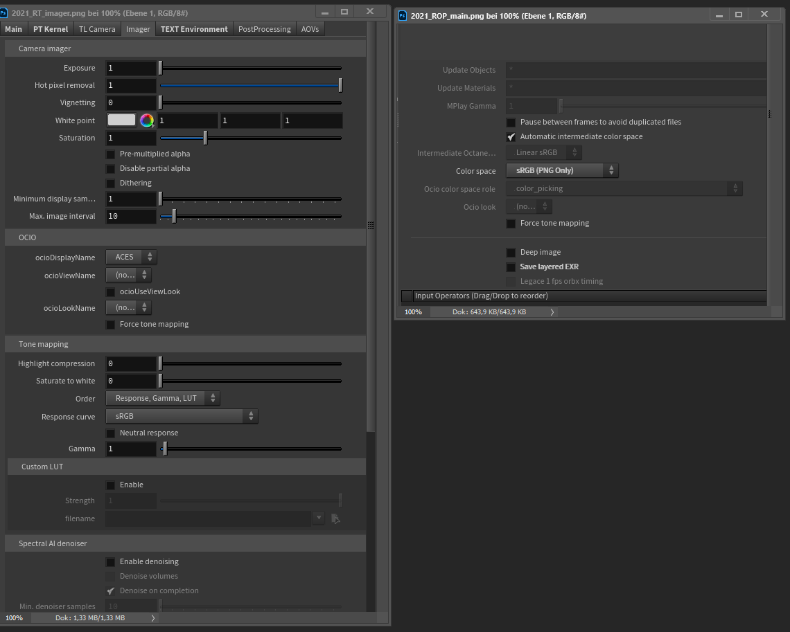

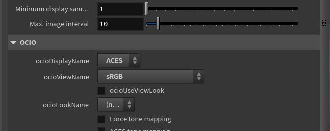

i guess it is due to color management that a scene built with Octane 2021 renders much darker in Octane 2022...
what did change? and how to get back to former brightness and colors?

yes the settings didn`t change... and settings are in the screenshot.
also i attached an example render where the difference is visible...
right: Mplay image with enable OpenColorIO deactivated, with rendering of Octane2021
left: IPR Octane 2022 - darker than right
left: IPR Octane 2021 - which is matching obviously.

a late followup,
i found the reason for my scene beeing darker in Octane 2022 as i found out that my problem is not colour-space or alikes but the keepInstancePower checkbox that was added to OctaneLights in 2022, and is on by default.
So opening a file built with a previous version, and using scaled Grid-Lights (surface brightness unchecked) leads to a quite different scene lighting... but is easily fixable by unticking this checkbox on all scaled lights unsed in the scene...
