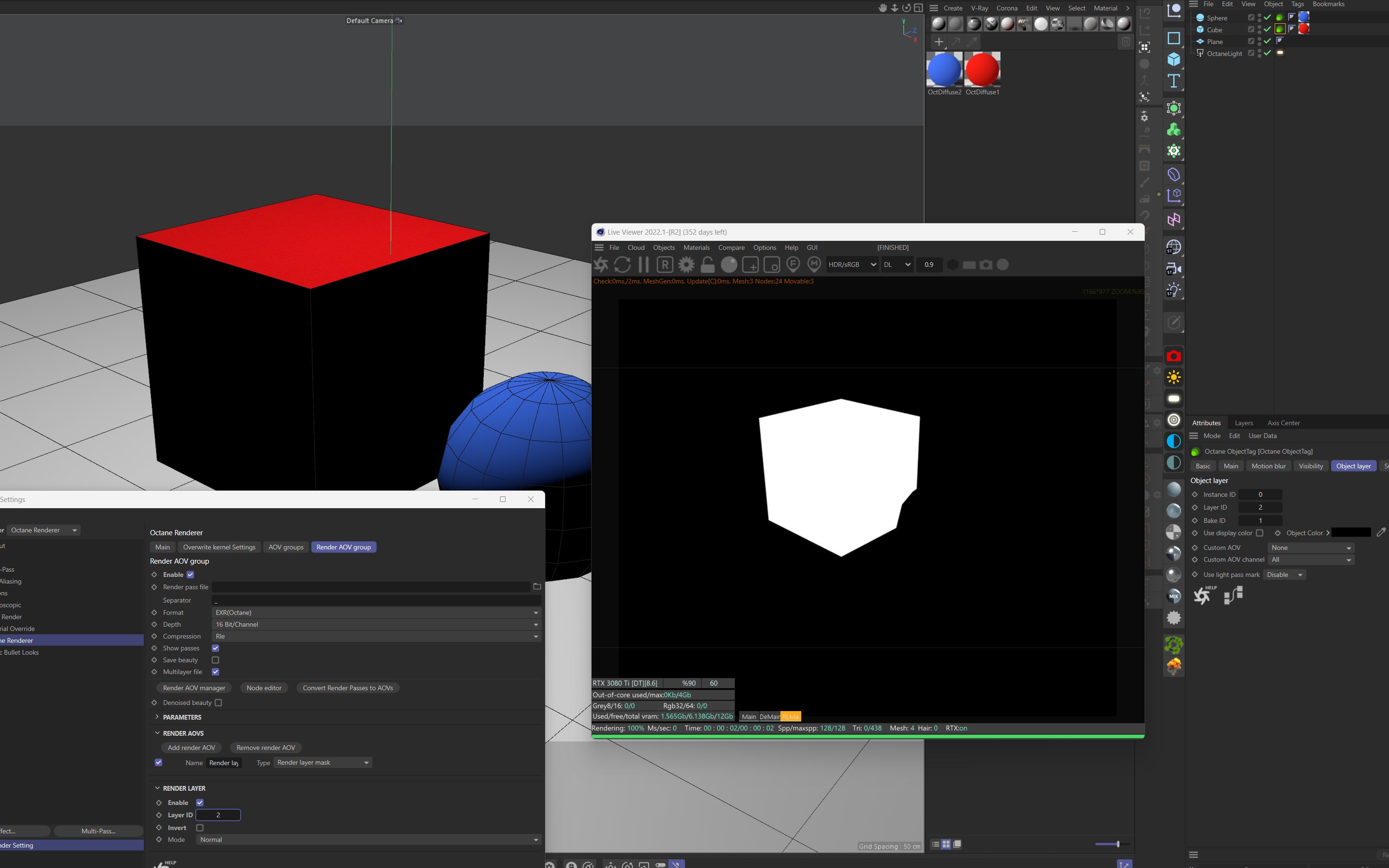

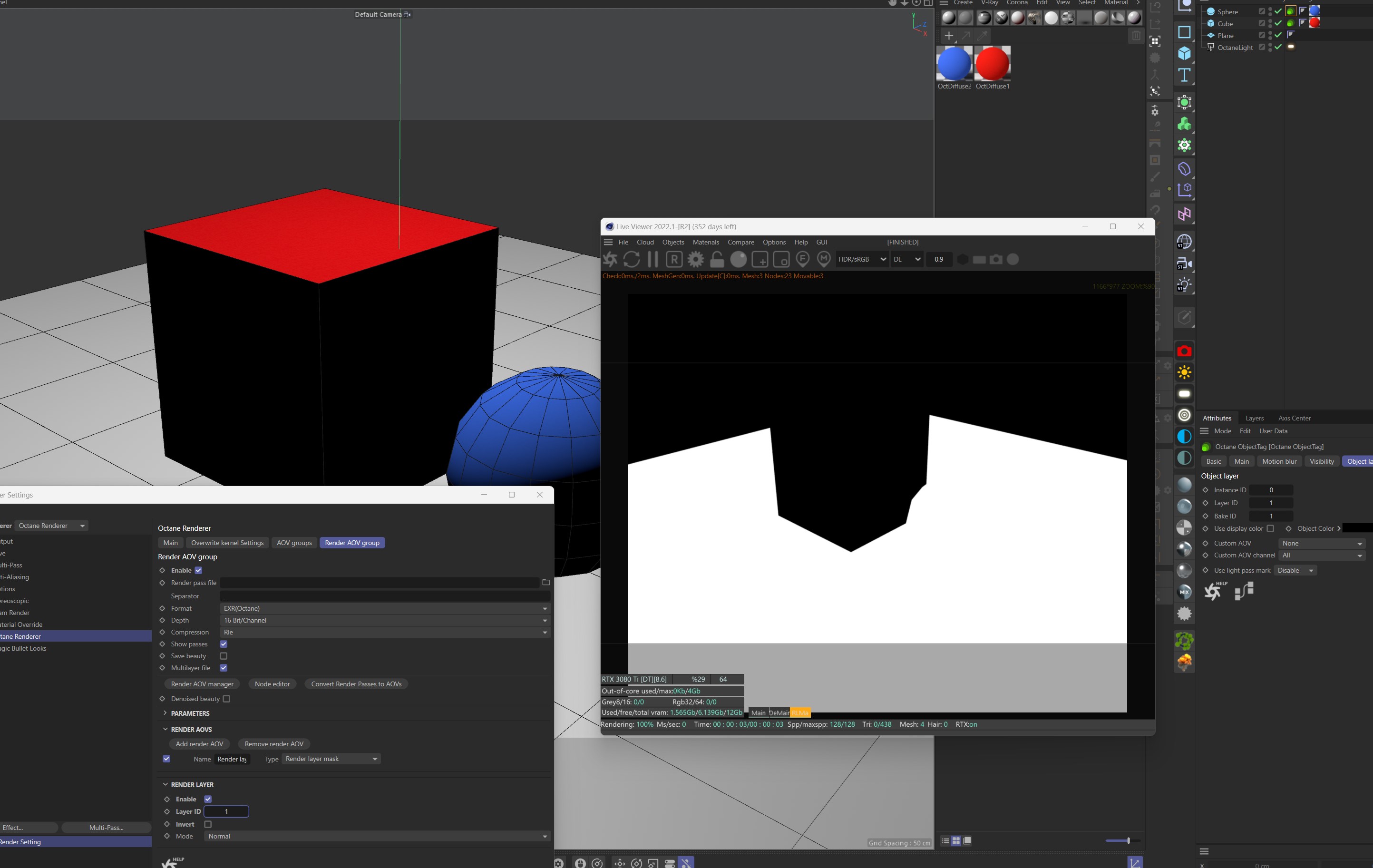

1- Layer ID 1 does not work. it is to sphere... showing floor mask. OR layer id 1 doe snot work.
2- I need separate mask of sphere and cube... how it will be..?

this is layer ID 2, cube showing, correct it is.

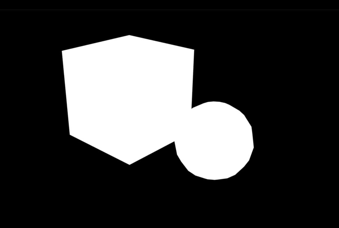

it is sphere mask... floor also coming.

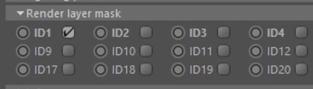

Thanks but its not showing object mask.
I dont need reflection or shadows or diffuse multipass.
In Simple... I need only separate mask of two objects.
Am I using correct multipass "Render layer mask" ?
this is one combine mask.. how can I do two separate masks...?
Thanks.

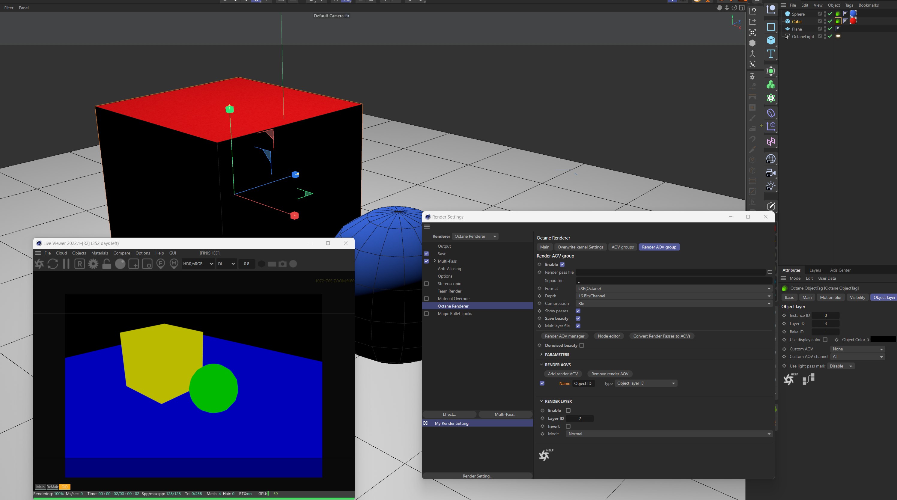

Layer ID 1 is reserved; it is used for everything in the scene as I recall. To isolate all objects from each other, give them unique IDs, starting with 2; then set up an Object ID AOV via the Info Kernel and you should be good to go.
Puget Systems / Intel Core Z790 ATX / RTX 4090 / Cinema 4D
iacdxb
Posts: 36
Joined: Tue Jan 12, 2016 6:07 pm
Like this... if I am correct with object ID...?
If it is, I dont need this colors.
agian... two objects id numbers 2 and 3 need two black & white mask layers.
Thanks.
