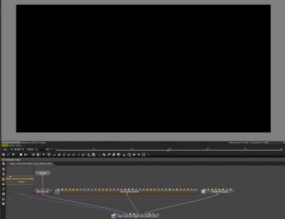

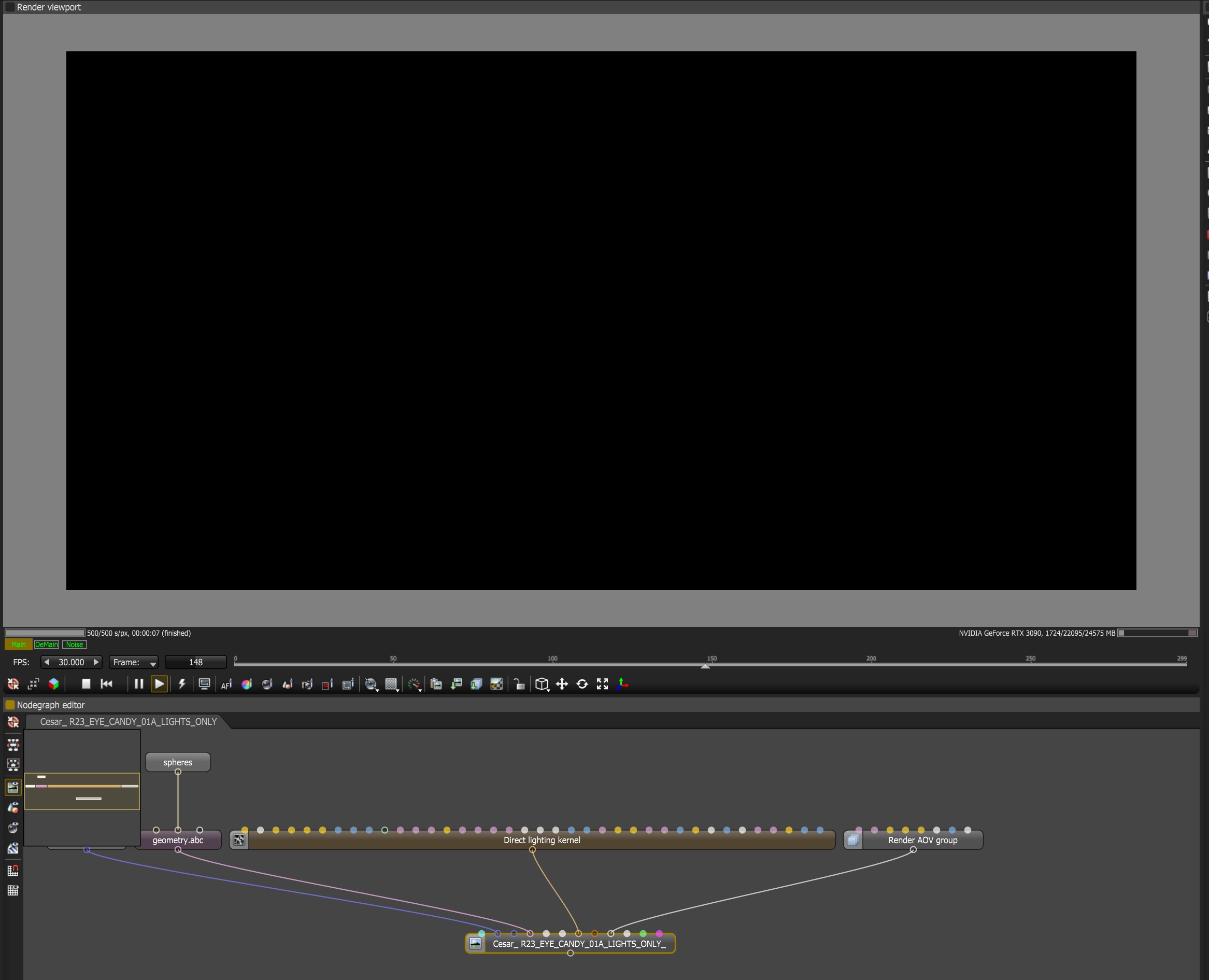

Now I can see the timeline but when I click the "Start Render" (Play button) or the real time render (Lighting bolt button) at frame 64 for example, it's just black on the screen.
Any thoughts?
Thank you very much!
-Snoopy

Make sure that the Render Target node is selected in the Nodegraph Editor.
Puget Systems / Intel Core Z790 ATX / RTX 4090 / Cinema 4D
Snoopy
Posts: 59
Joined: Sun Dec 04, 2011 4:20 am

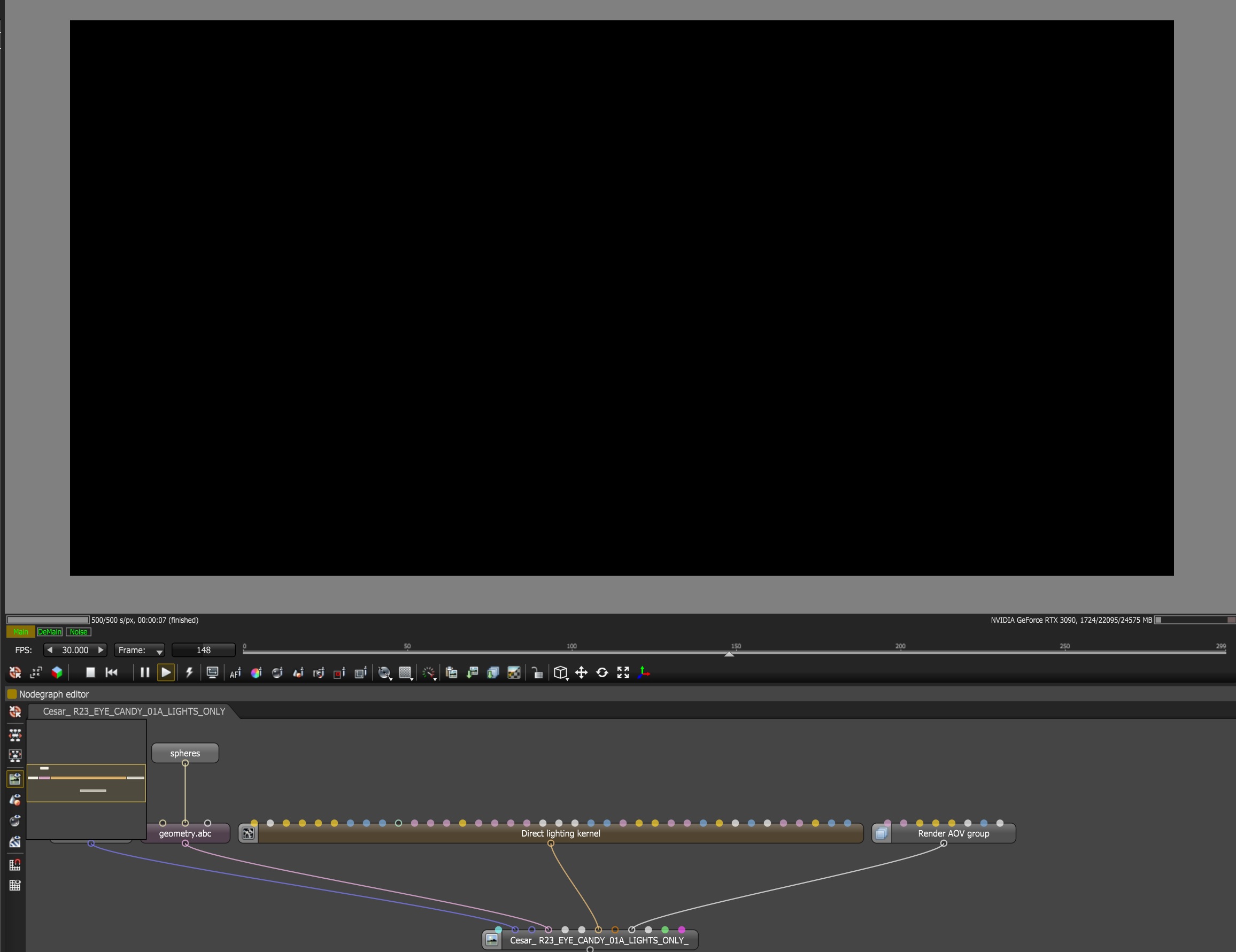

Hi jayroth2020, yes it is but there's nothing on the screen, sorry if I am missing something obvious
Snoopy
Posts: 59
Yes, but still nothing

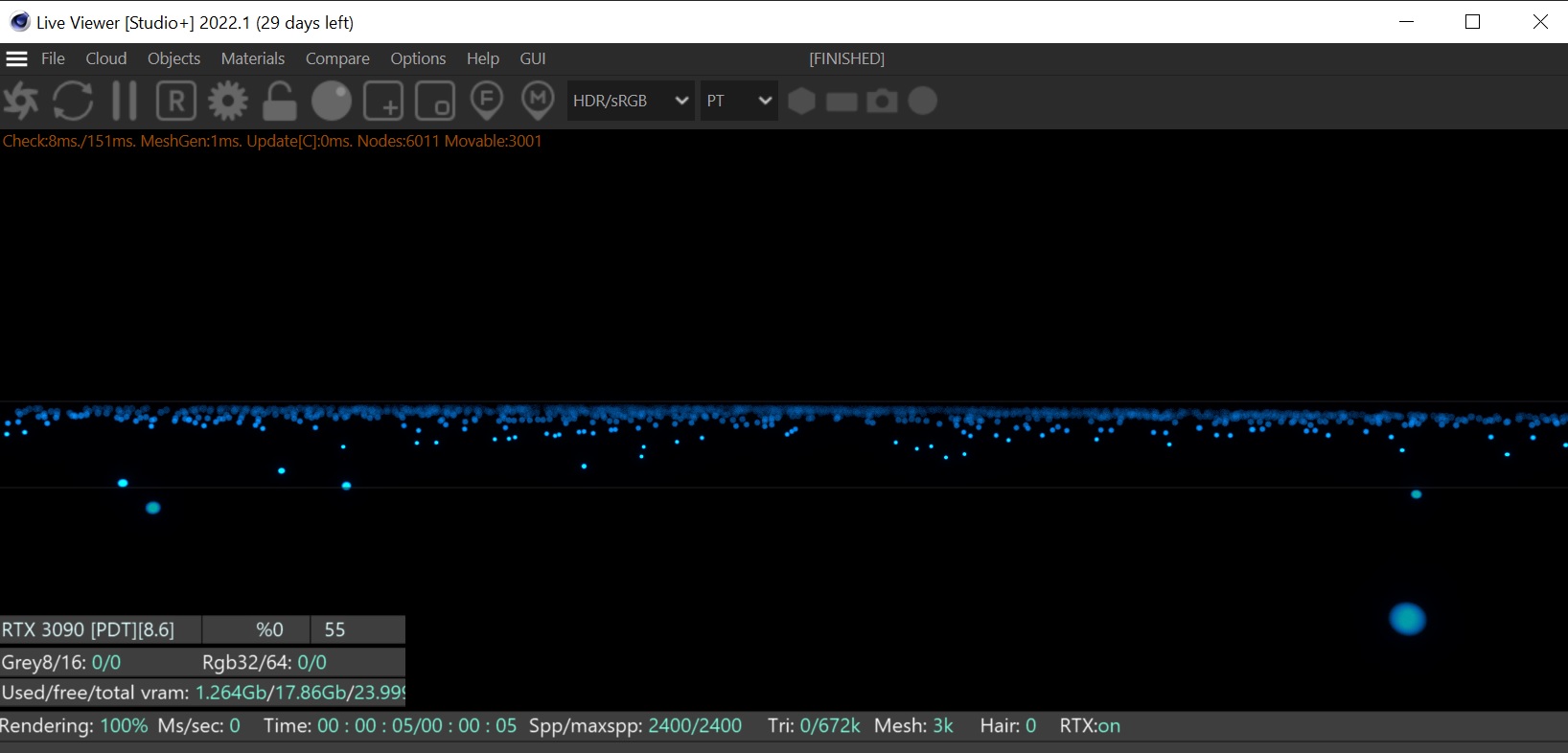

What does the same frame look like in LV in Cinema?

Snoopy
Posts: 59
Hello jayroth2020, here's a screen shot of LV.
Please let me know if you have some ideas I could try!
