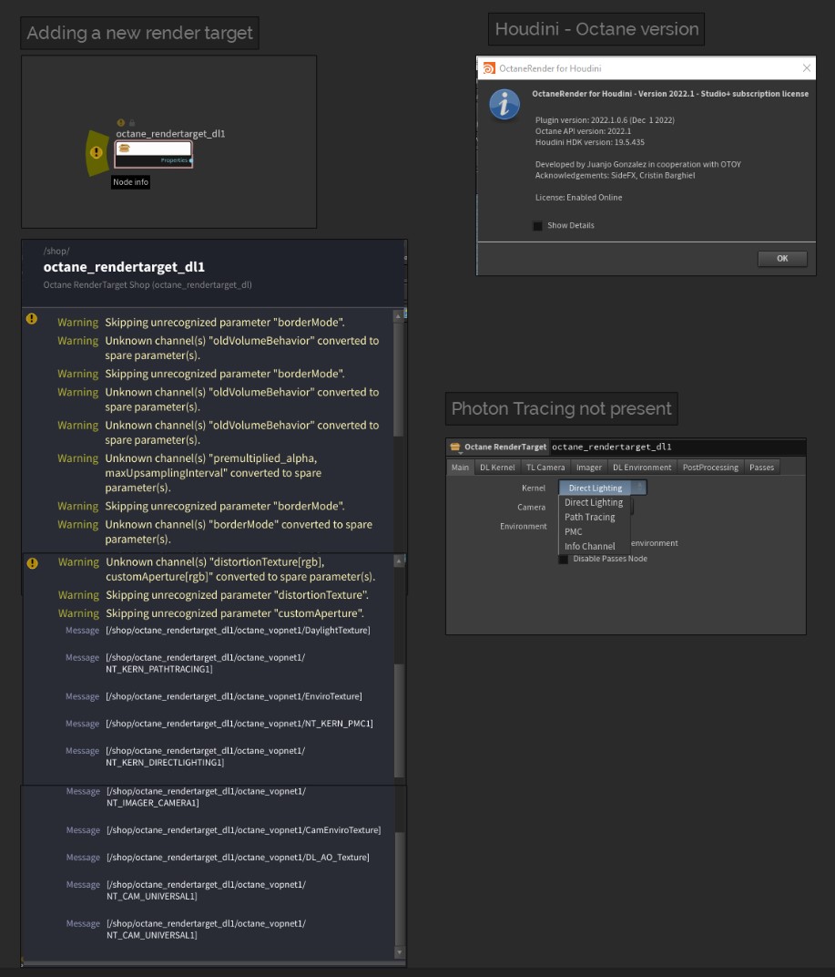

Hello,
I really like the look of Octane and I really want this to work smoothly on my pc and therefore my projects. I have been using Redshift but I like the look of Octane better.
I'm having some issues and I don't know if I'm doing something silly but I'm having some warnings and messages every time I add a render target and I can't see the new photon tracing kernel either. I have had some crashes while I'm working but I don't know if this is related to these warnings. Please see the image attached.
I would appreciate any help with this.
Cheers!

It seems that you are using the old render target hda that is in the shopnet context. You should be using the one in the matnet context.
Shopnet is the old way of doing things. Everything is done in matnet now

Thank you! I couldn't be happier. It's working really well now.
Cheers!
