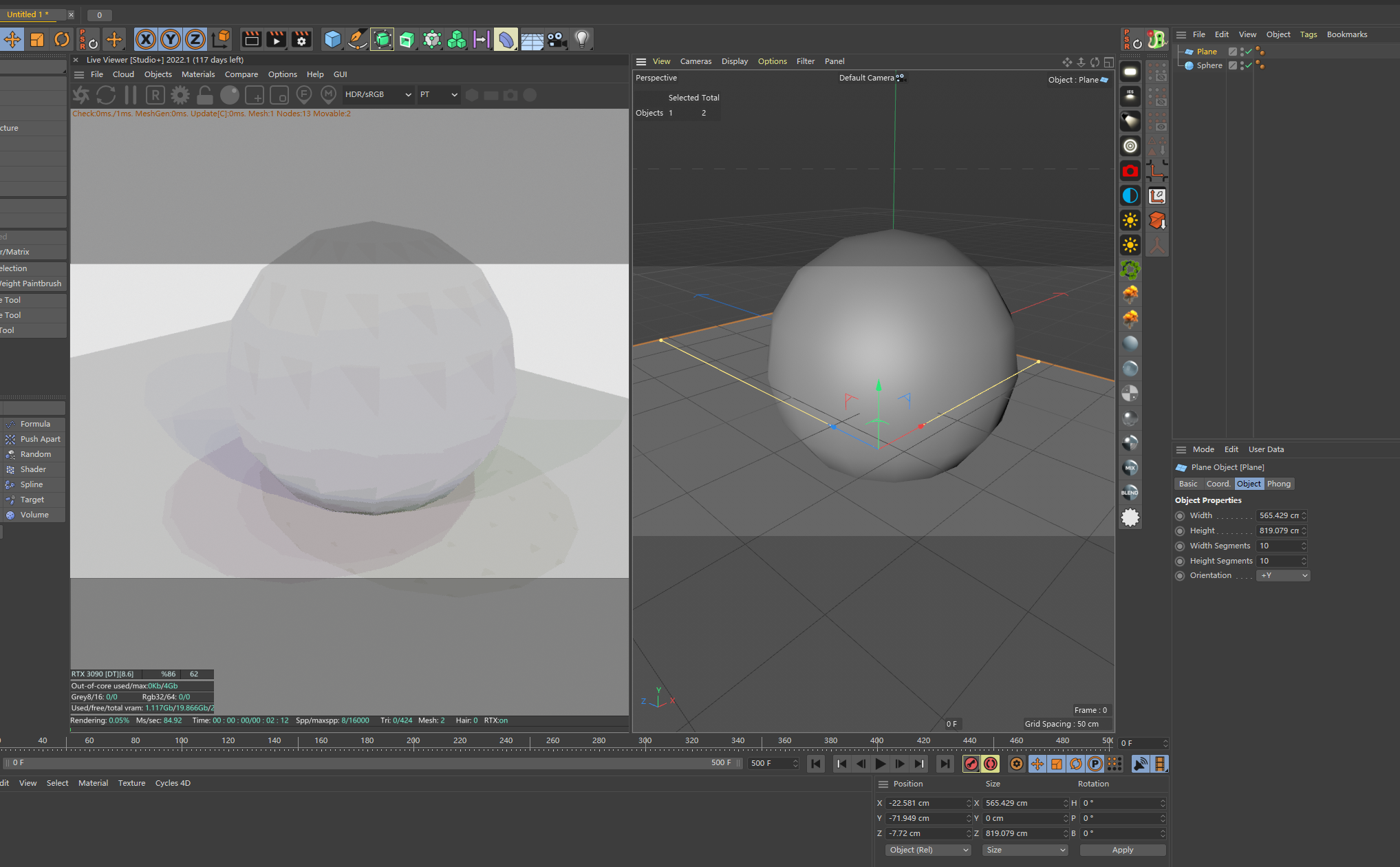

Every time refresh there is not correct color in the viewport.Don't konw what's problems.
And the render is not correct.

Coherent_ratio should be 0. Version converter is doing a convert to coherent_ratio when open any scene. Your template scene is causing this most likely. Make a new scene and save as "c4d.new" as you did in past. Then coherent_ratio will be 0 by default.

Thanks~!It work~!aoktar wrote:Coherent_ratio should be 0. Version converter is doing a convert to coherent_ratio when open any scene. Your template scene is causing this most likely. Make a new scene and save as "c4d.new" as you did in past. Then coherent_ratio will be 0 by default.
