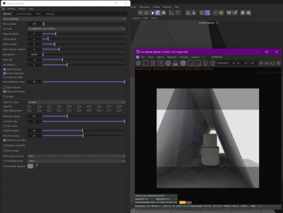

Hey there. Got a strange behavior here with the LiveViewer. Any ideas?
Geforce2080 TI with newest drivers.
Octane 2022.1
Windows 11, Cinema 4D R2023

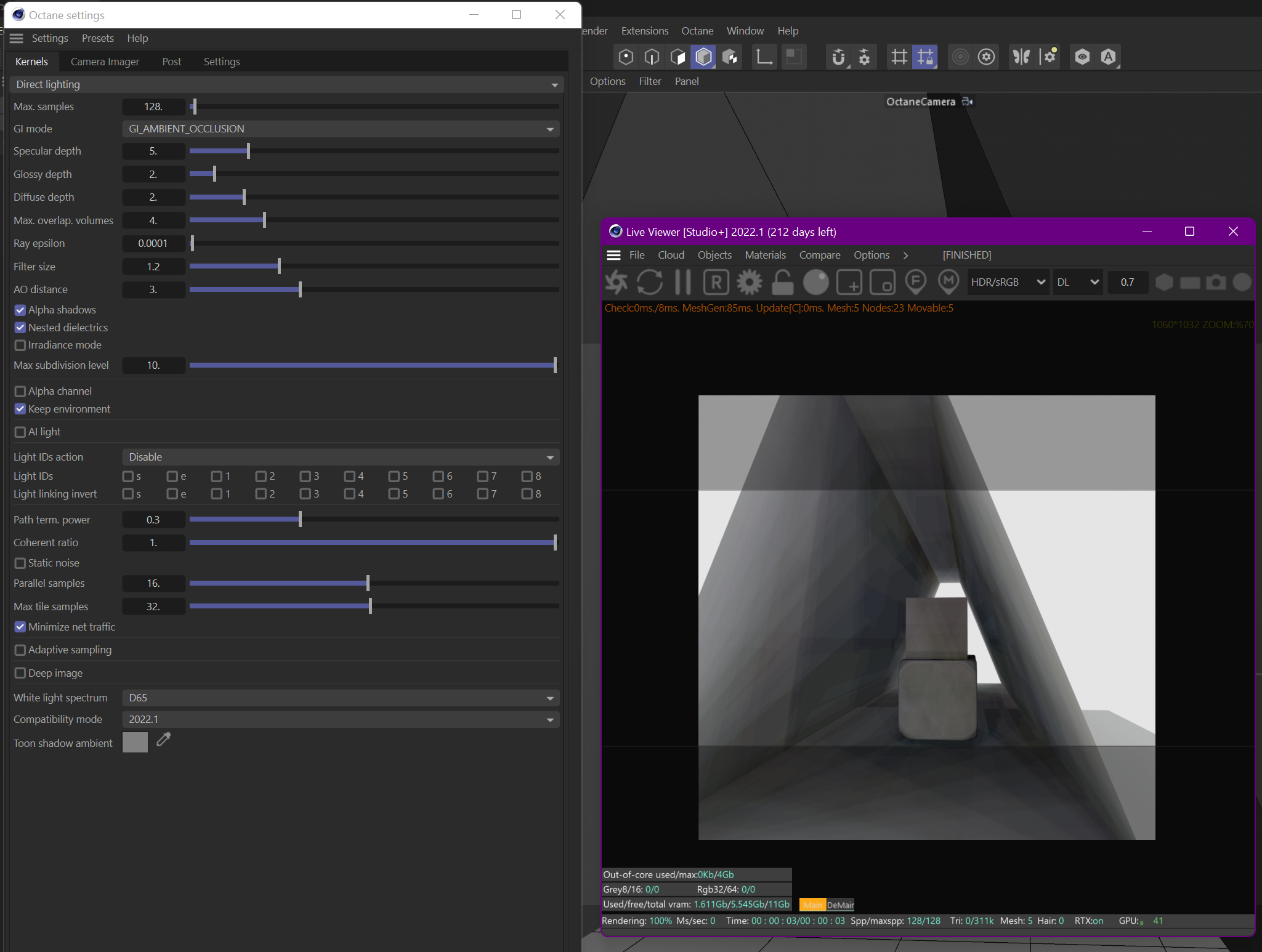

can you share a complete screenshot of Kernel panel?
It seems caused by a too high Coherent Ratio value.

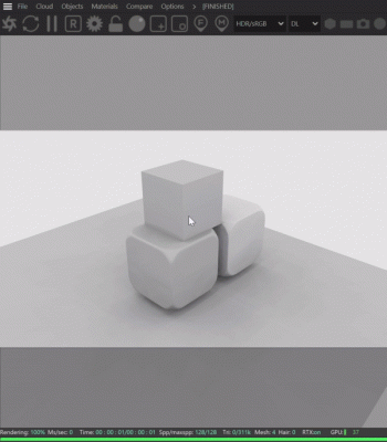

It also produces strange articats in the shading. Dunno. It´s a Fresh install of Octane, and vanilla settings.

But yeah, lowering the Coherent Ratio to 0.5 fixes the problem. Just wondering why it produces these results at a default setting of 1.

Please also note that, if Coherent ratio is not zero, you must enable the Static Noise option, or you will have flickering results in animation.
