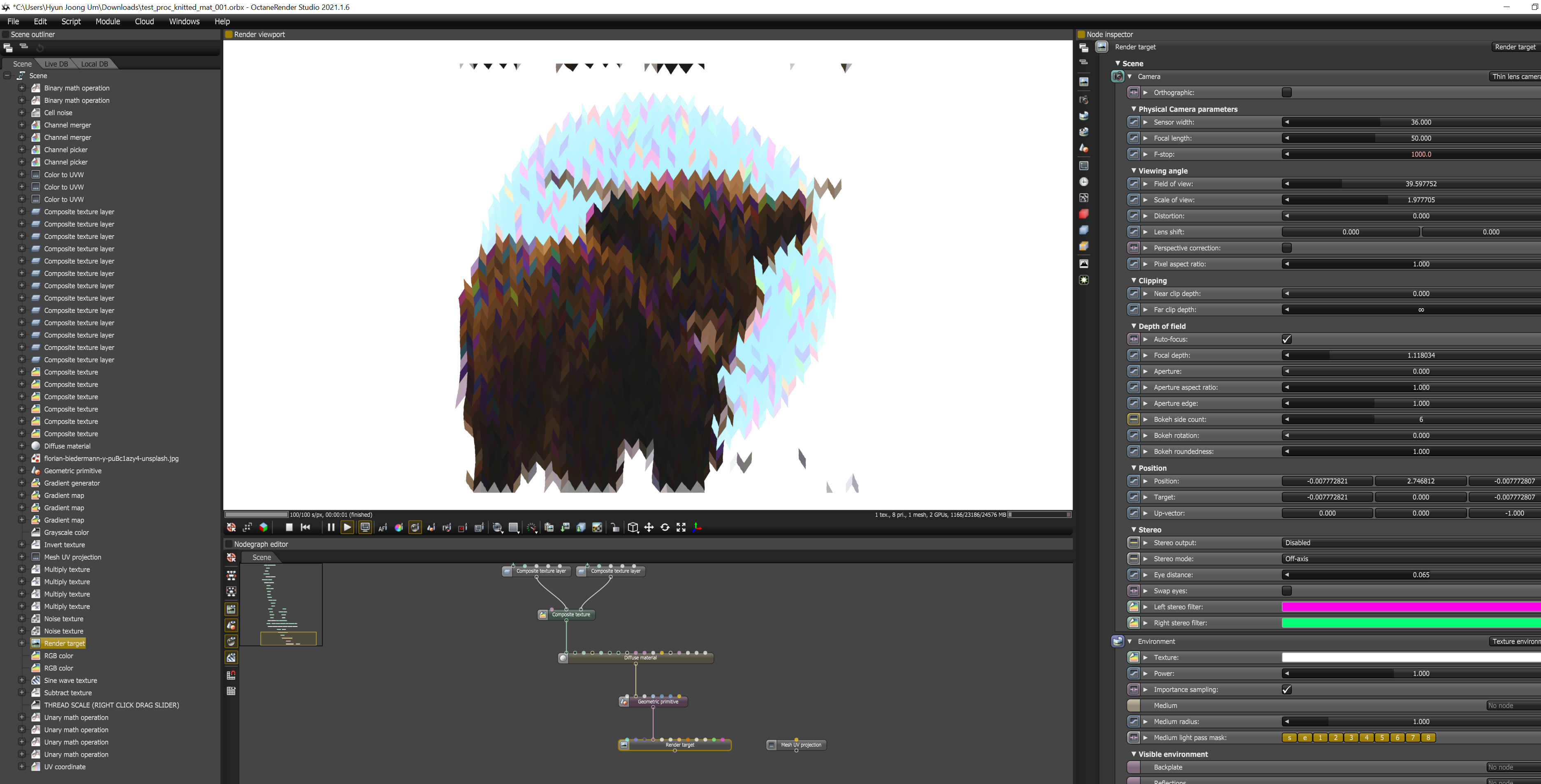

funk - that's so awesome! I tried downloading the orbx but when I render it it shows me this:
Granted, I barely know my way around the Standalone program so I might be doing something wrong.

You'll need to use 2022.1 RC3 or greater: viewtopic.php?f=33&t=80788Jengo_1 wrote:funk - that's so awesome! I tried downloading the orbx but when I render it it shows me this:
2021.1.6 is missing some newer features which I'm using (like the unary math op texture > length option)

I'm on the 2021.1.6 windows standalone, maybe there are some conversion issues?
