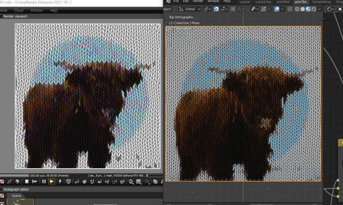

I'm not a C4D user, but that "knitted materials" tutorial looked really cool so I followed along in Octane Standalone (I stopped at about the 12.5 minute mark).
It looks like we have everything required to copy this particular tutorial. I have attached an ORBX (made in 2022.1 RC 3 standalone) so you can take a look.
Here are some notes:
- Octane doesn't need specific "vector" nodes because RGB colors = XYZ vectors. eg. Blender's vector length node can be done with any color input into Octane's unary math op texture > length.
- Blender vector inputs for texture mapping are done by using Octane's "Color to UVW" projection node.
- Some of the terms are different so you need to figure out the equivalent operations. eg. Blender's Step node = Octane unary math op texture > truncate.
- Octane obviously doesn't have all the exact same nodes, so you need to improvise sometimes. eg. A couple of nodes like "ping pong" were emulated using a combination of other Octane nodes instead.
- I did a few things differently when it came to creating the cow composite, since we have a nice composite texture with multiple inputs.
test_proc_knitted_mat_001.orbx
(266.27 KiB) Downloaded 98 times
