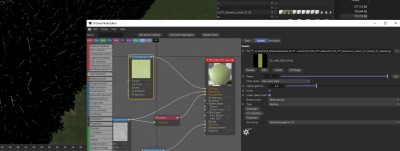

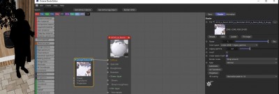

There is a small issue with it's tendency to show black material either on scene load or on Remove duplicate material. The Remove duplicate material one happens a lot.
These are extremely simple Glossy materials with only Diffuse channel loaded.

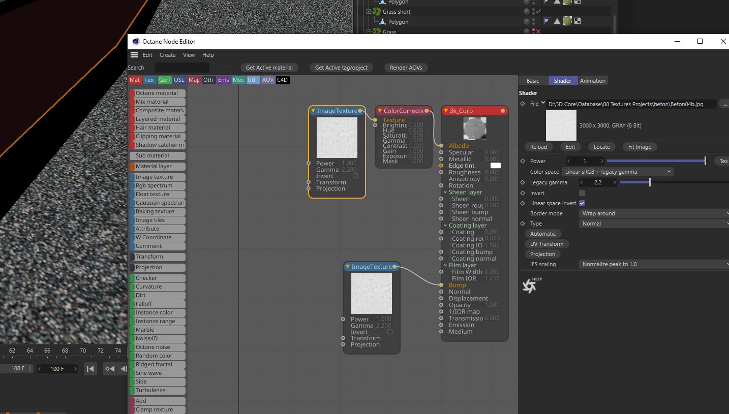

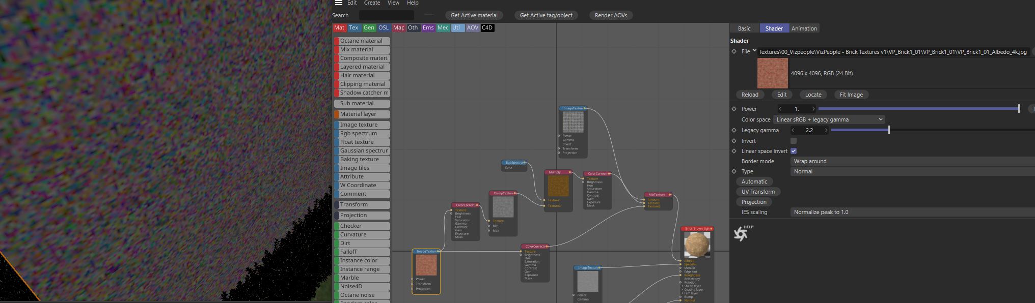

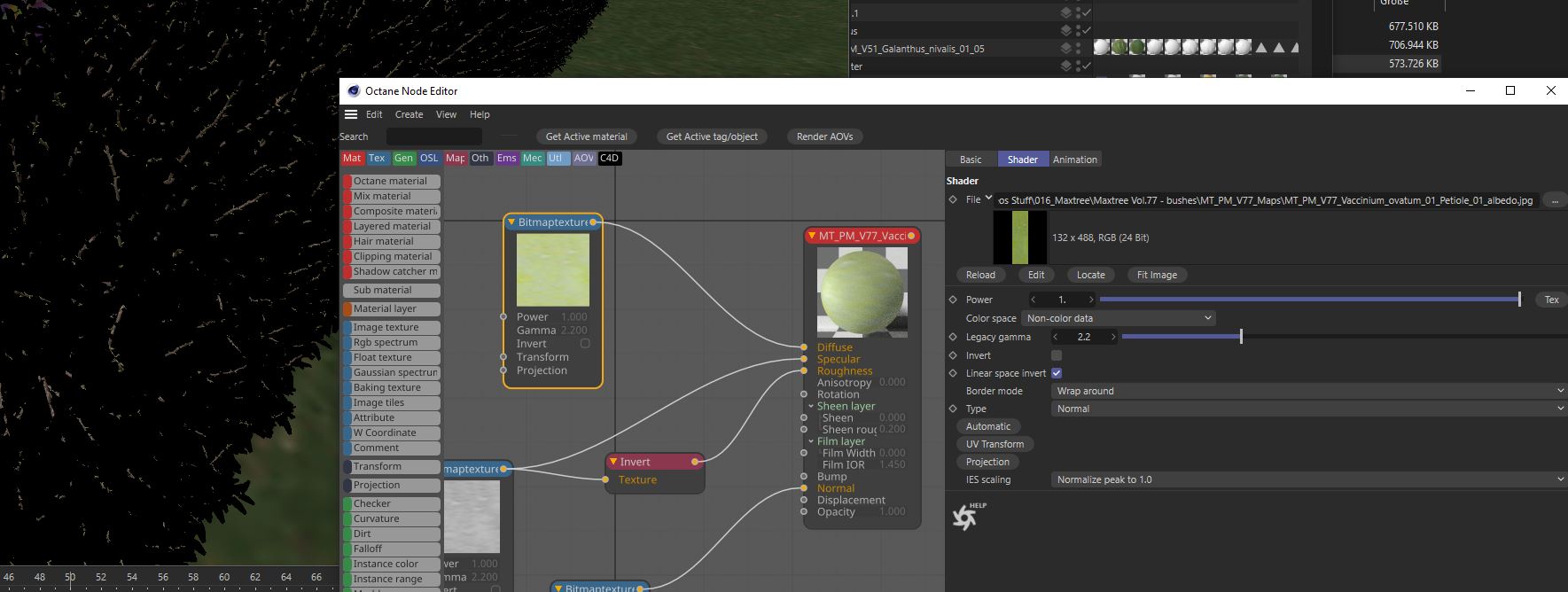

How about it, i just opened a random project of ours and found 3 examples plus 1 extra which isnt blacking out the texture in the viewport but is fuzzying it.
Note: We have "Use Octane for OPENGL previews" turned off by default, because we find it annoingly slow

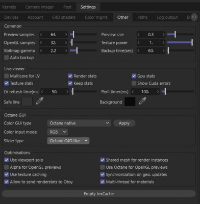

Show me you settings/other page. There is a new option to calculate material/viewport previews/textures in background and also caching. This is avoiding the lags of viewport textures. I cannot think a relationship with having different image formats. Maybe related to a specific version. Because there was several trials to do this functionality in some versions. As I said above, I'm aware of some glitch and I'll try to fix as said. You should understand that nothing is simple in plugin development. There are complex structures to be stabilized/improved. Takes time and needs feedback.

here you go.
