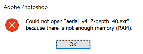

Having exactly the same issue with the same render settings.
Octane: 2021.1.6-(R4)
Cinema 4D: 2023.0.0
After Effects: 23.0.0
The file seems to be corrupted, because it generates a strange error about RAM, while trying to open in Photoshop. But my file is only 1280x560 px and 160 kb in size.
It was rendered in RNDR Network.
I couldn't render it at my local machine — the render frozen after rendering 1st frame, the render process was going but it never started to render the 2nd frame.
When I changed file format to EXR (not Octane) and it rendered sequence of frames as expected. But while rendering EXR in RNDR Network it still renders corrupted file.
